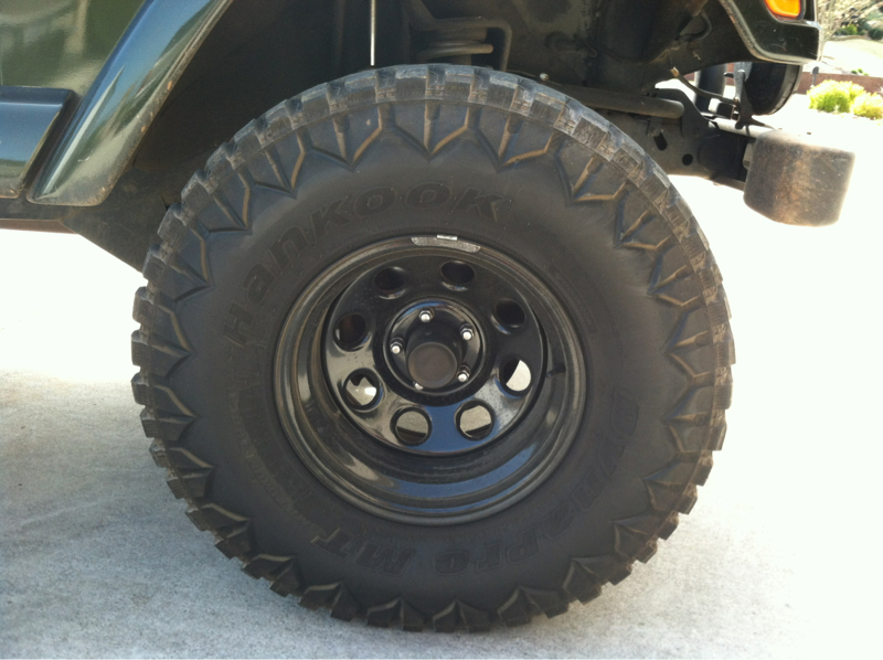

I have a 98 wrangler Sahara edition with a 4 inch lift and 33 inch mud terrain tires. I'm moving from Alabama to Texas and Ill be traveling back and forth frequently but I don't want to get rid of my baby. So, I will have to make some upgrades to help with MPG to make the trip a little less heavy on the engine and a little less expensive in the long run. What upgrades could I make to help?
Tires and rims
