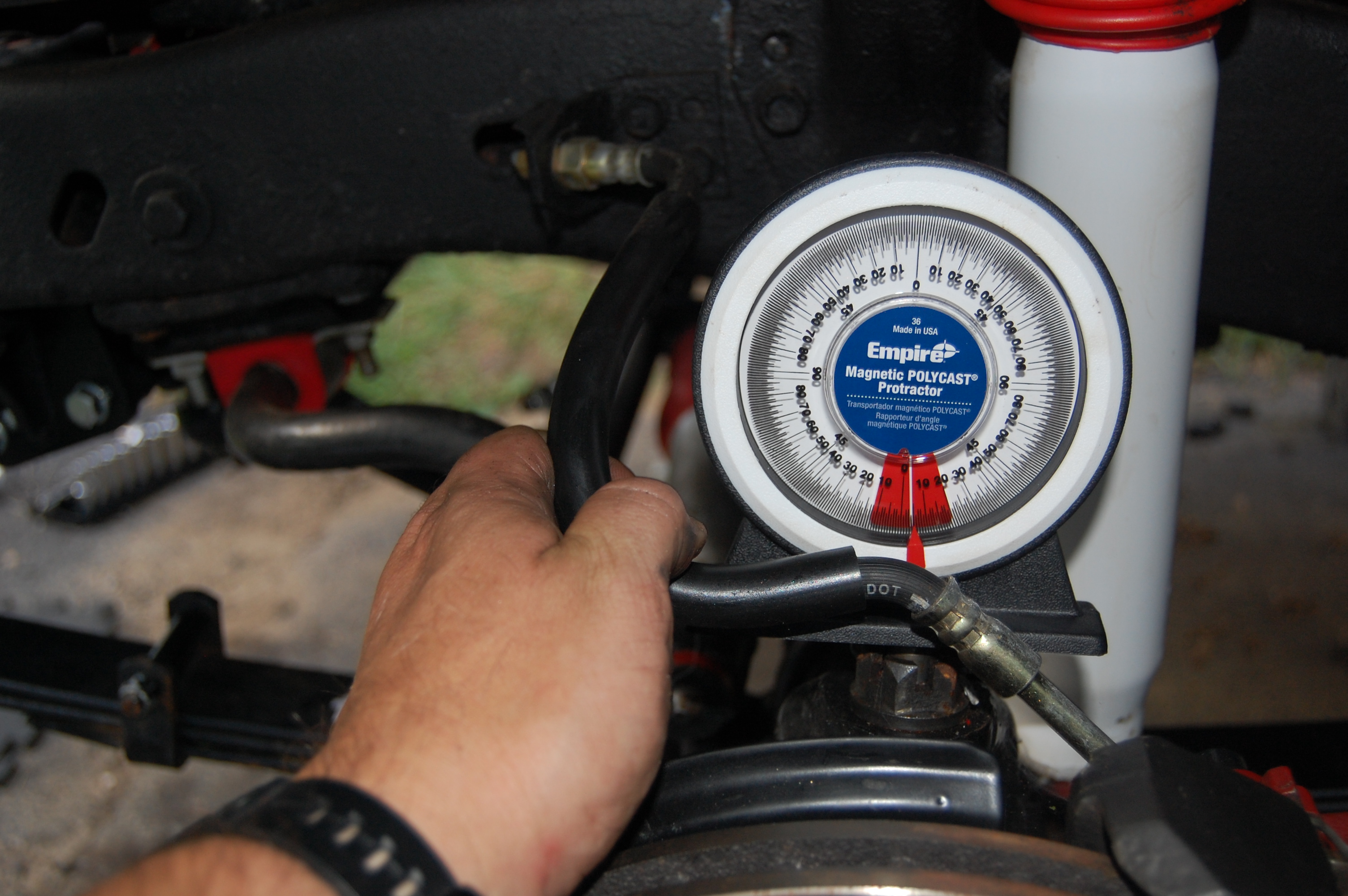

I measure mine with an angle finder across the top balljoint. +5* to +8* is desired.
Hey GennyBro...... This would be one way of measuring your caster angle. You would want the vehicle to be as level as possible and the front axle preloaded with the it's normal weight (i.e. on jack stands). You can also measure from the bottom ball joint, but your readings would be inverted. I can't find the photo of that one? The tool cost me about $8.00 at HomeDepot.
