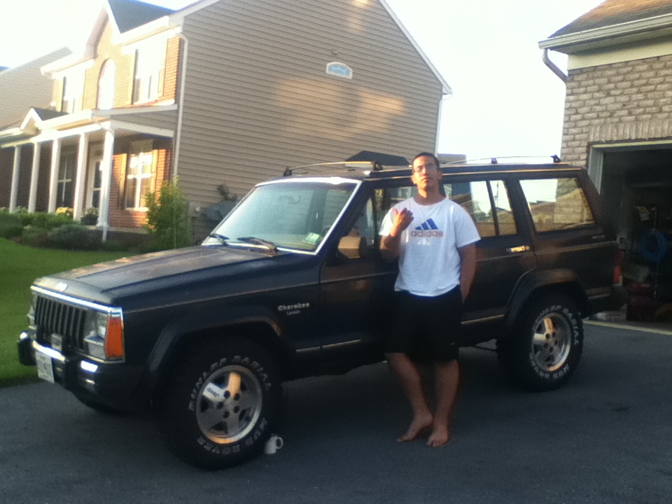

I am trying to lube the u joint at the front of the transfer-case of a 1987 Jeep Cherokee Laredo and there is not Zerk fitting. How do I grease it?
Best to search the forums, if you can't find an answer start a new thread.
Welcome, I'm a newbie too.
Your u-joint is not grease-able. You'll have to change the joint.
raising the dead.. the only way to do it is to pull the joint out and pull the caps off the u-joint, just a little dab of grease o nthe end of the trunnion and carefully put the cap back on, make sure there is no gaulling on the trunnion or the roller bearings don't look flat. other than that, replace the joint with a greasable unit.
