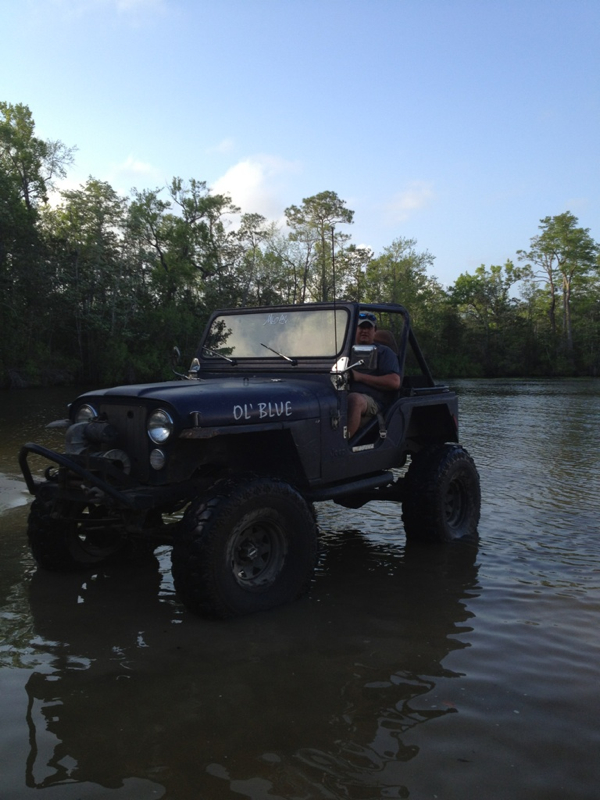

Yeah had a 1980 cj5 with ford 9 and a spool.

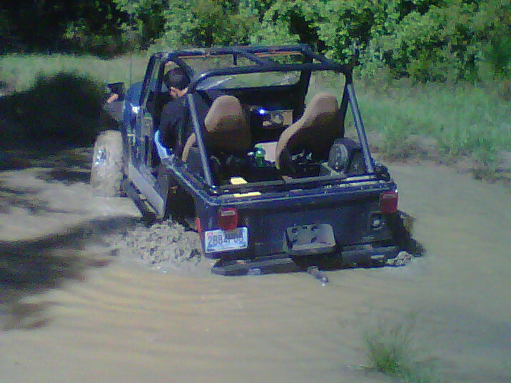

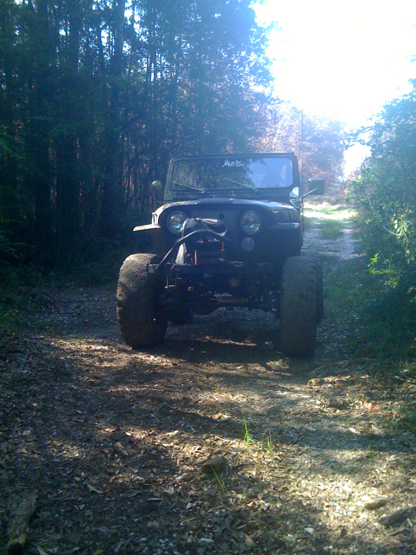

Yeah had a cj5 with ford 9 and spool
