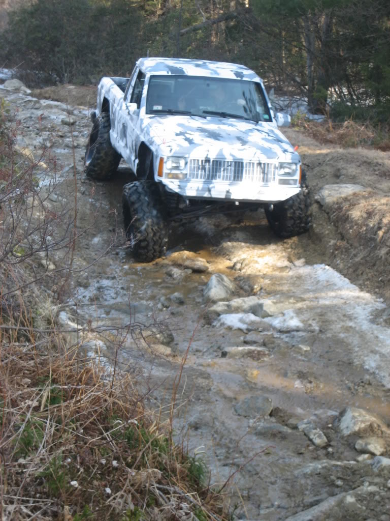

Not the best pics, but this MJ had a d35 rear, was bone stock, welded spyders, 35x15.5 sx swampers, lived a very hard life. wheeled hard for about a year ( almost every weekend getting flogged) and the rear d35 never broke... infact, the jeep split in half before the an axle broke. the saving grace for this jeep was that it was a 4cyl and auto, so a lot less abuse than if it was a 6cyl manual.
