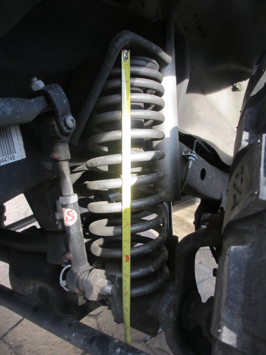

I've read you can take a measurement from your spring ends and subtract a number and that will give you your lift height. Upon looking at the huge space between the top of the tire and the wheel well I'm not sure I "calculated" the correct height. These are 31's and they do look tiny when you stand back and look at things.
So, does anyone out there have a 98 TJ with 31's and a known height? If so, what is the measurement between the top of the tire and I guess top inside of wheel well?

It's not normally that easy, since springs settle after a while.

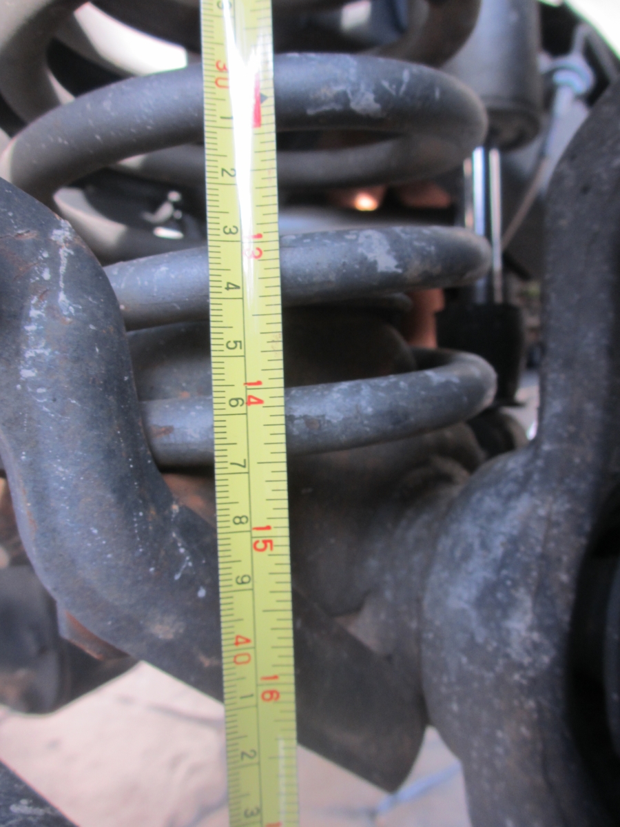

I'll measure my springs tonight. I'm not sure if that will be very exact, but we'll give it a try.
I'm running some Rough Country 2.5" lift springs that are a couple of years old. They seem to be about 14.5 inches in the front
