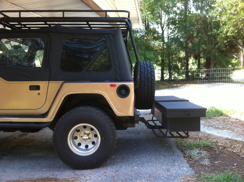

anyone know where I can get air shocks for the rear of my 99 wrangler. I've looked all over the place..Gabriel and Monroe have waft I want but they dont fit..I have a diamond plate toolbox that sometimes rides on the receiver and I'd like to pump them up thx
you mean air springs. basically a supplemental rubber bladder that get installed inside the rear coil and under heavy load you can air up to compensate for the weight.
Firestone and Air-lift are the way to go.
If you want a replacement shock that can help support a load, I personally do not think it is a good idea since the shock mounts on a jeep were never designed to support any weight, but I ran a set of shocks with a coil spring on the rear of my pickup years back to help with overloads. I got them from JC whitney and they were moderately effective at best. I ended up going with Air-lift set up.
ya, thanks. I may have to go with something like that or just leave them alone. I don't carry the toolbox all the time. Gabriel skyjackers or Monroe AirMax look like what I want but they don't fit. thanks for the link
