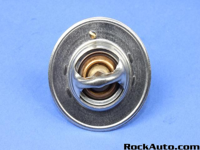

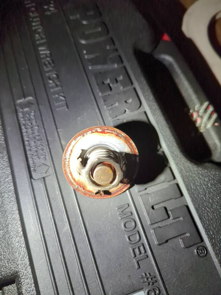

The trip started off on the wrong foot. I had made it 2 hours out of Virginia when the temperature began to climb. I was okay on the interstate but it would overheat if I came to a stop. I ended up buying a water pump thermostat and fan clutch in New Jersey and then installing them at 11:30 at night outside the Airbnb in Pennsylvania. I actually had to install the thermostat and water pump twice because the first time I didn't scrape the gaskets off totally and it leaked like crazy.
I haven't tested it in boiling water, but I think the thermostat was the culprit. It looked pretty crusty
