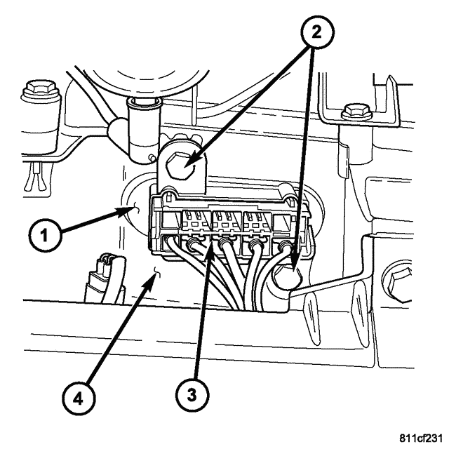

I'm 99.9% positive that you need to replace the resistor block. It's behind the glove box.
