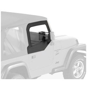

You can use half doors with the hard top, but you need to be careful which uppers you buy. Standard YJ uppers have a square corner like this:

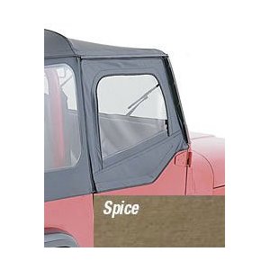

however since you have a hard top, you'll want one with rounded edges like this:
I can't remember how the windshield of a YJ attaches, but the main portion of the top is held on by 8-10 standard bolts. It's pretty straight forward.
yup, you remove that little channel the soft top slides into and the screw holes are where the hard top screws into. ours has a hardtop and is a 93.
