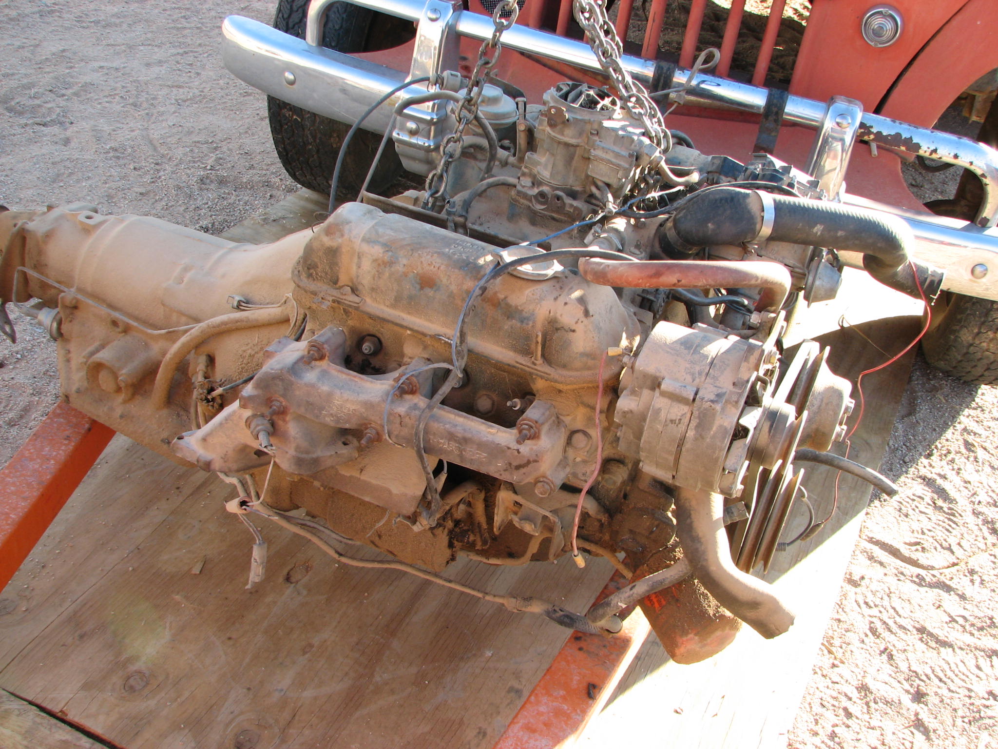

I think the odd fire Buick 231 is a good choice. I was going to put one in a kit car.

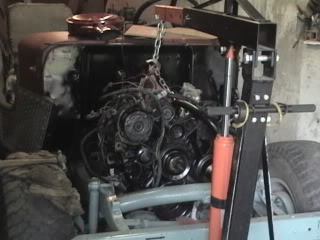

I'm working on mine 4.3 feul injected with dual exhaust sm420 trans/dana 18 tranfercase fits like a glove as I test fit it but well see after I install it lol
Heres a few of the 4.3 going in fits tight like a glove and no room for error
since I need to keep clearance from front diff and drive shaft and still allow room for exhaust!!!

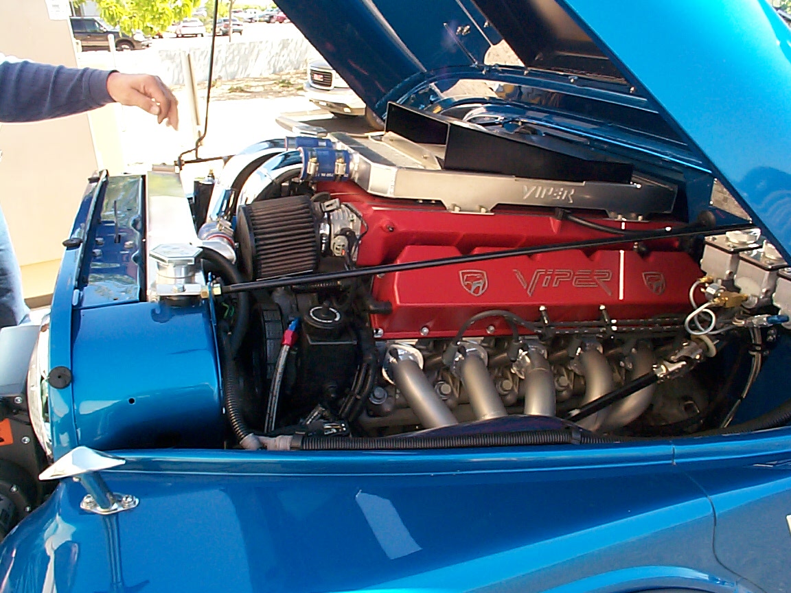

found what you seen this on another site a while back this is what a tight fit is all about lol.
OK, I KNOW that it is common thought that one can never have too many guages, horsepower and torque but when does too many turn into obsessed craziness? THAT IS NUTZ!!!!:crazy:
