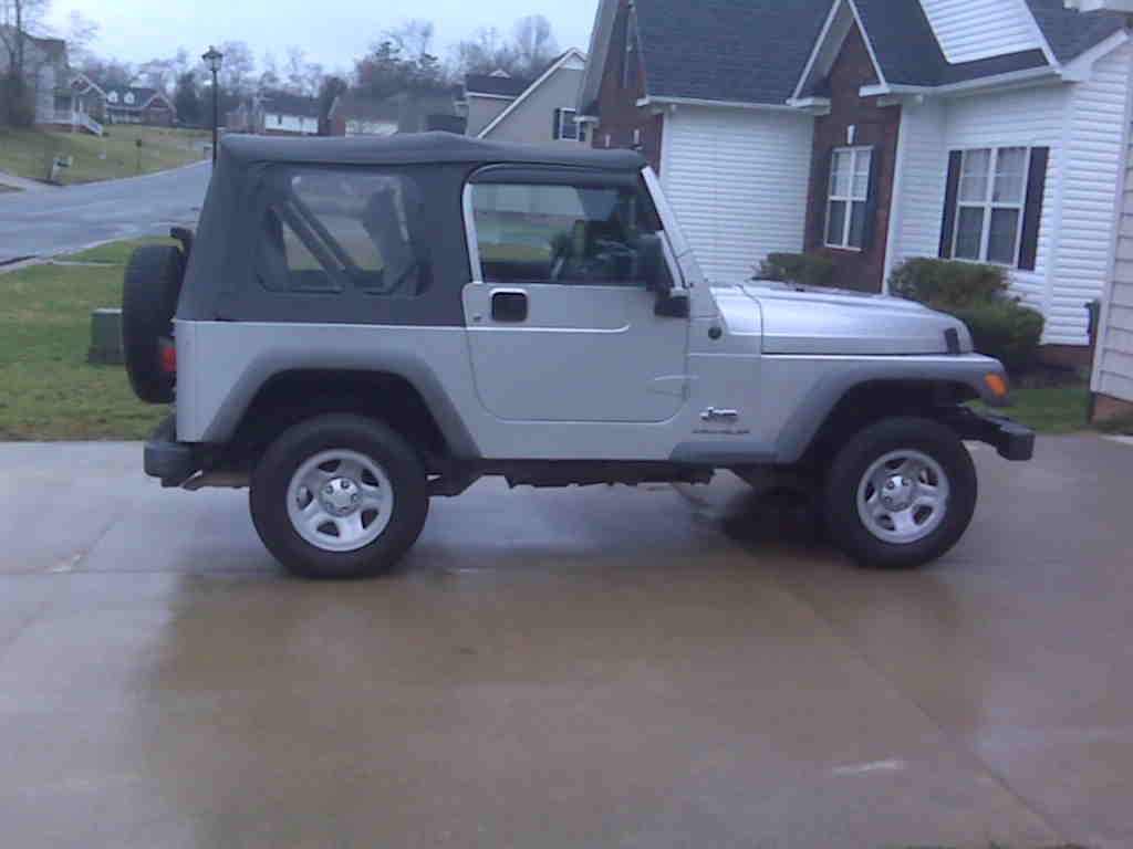

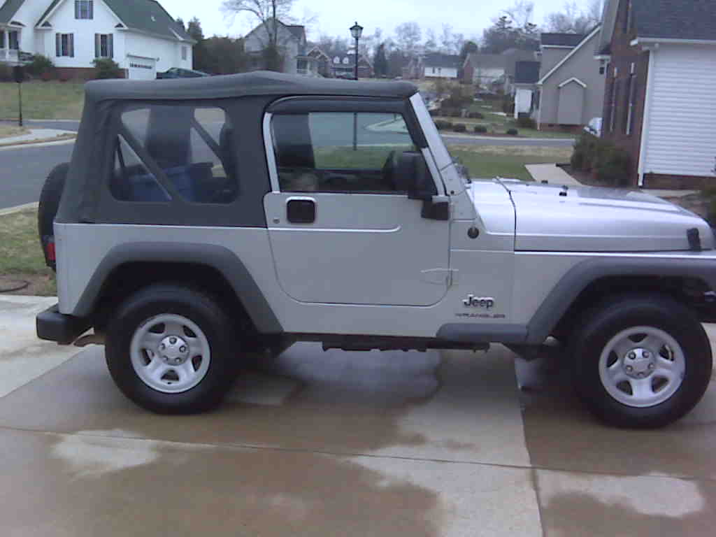

Thanks for all the tips. I went back and took the passenger side off and completed the d-side first. After I did the d-side, I didn't have any troubles getting the passenger side in. I am guessing it was a fluke. all in all it only took me about 4 hours to complete it by my self. again guys, thanks for the advise.

4 hours ain't bad for a first time. Consider adding another set of stock coil isolators (5/8") to the front spacers to level the jeep a little more.
