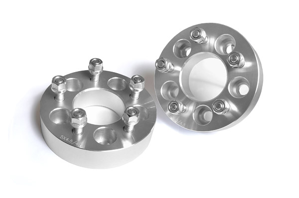

Installed wheel spacers => Death wobble??

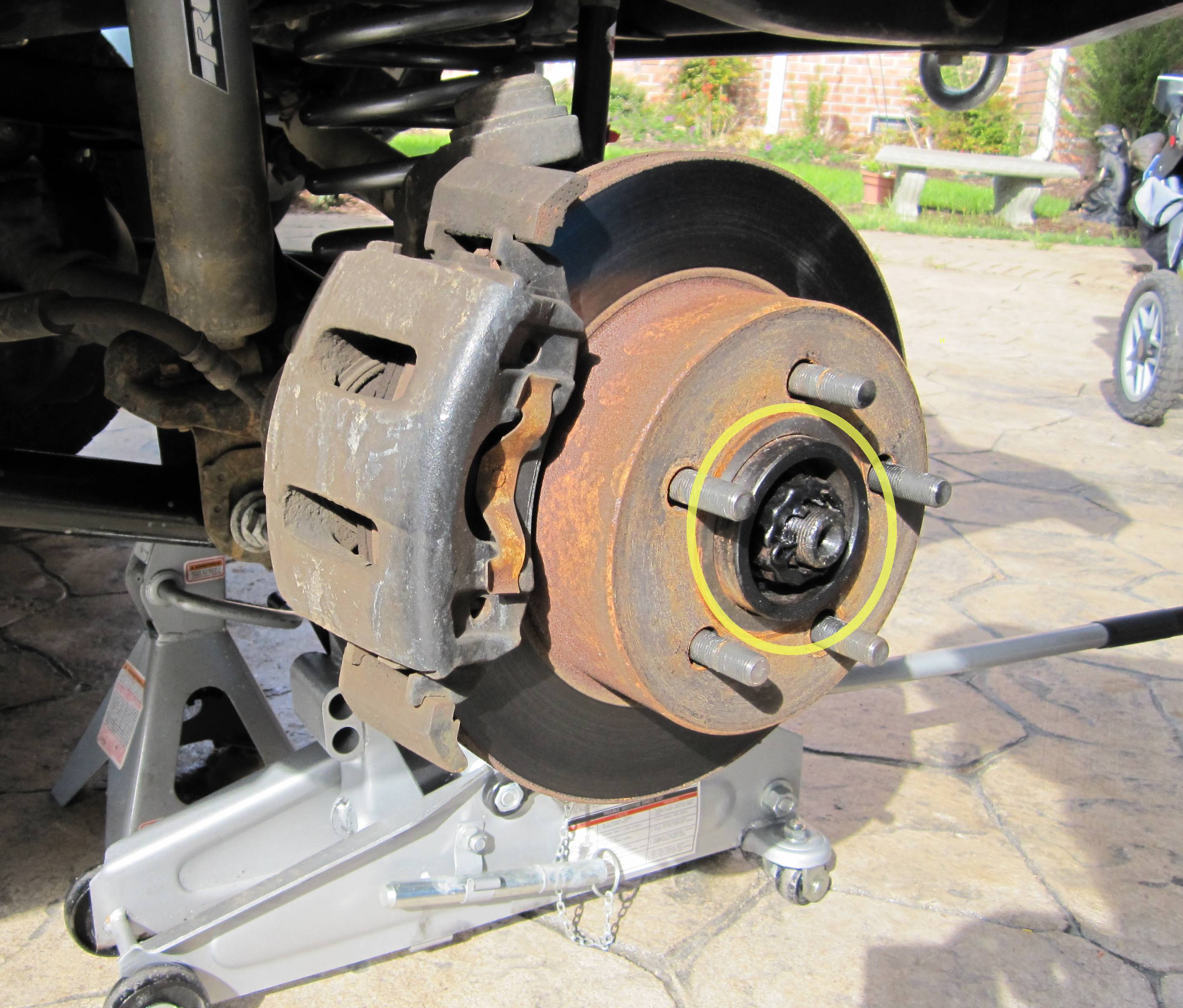

I was asking around the office about this and one of they guys thinks it's because your wheel spacers aren't hubcentric. Here's how it was explained to me:
A stock Jeep has a lip on the hub that the wheel sits on. The lug nuts don't keep the wheel centered, they only provide tension - the lip centers the wheel and supports the vehicle weight.
Your new spacers don't have that lip (they are called lugcentric). The lugs not only center the wheel, but also have more sheer force applied to them, since they now support the weight of the vehicle. There is probably a small amount of play, so every time you remount your tires there is a chance they could be in a very slightly different position.
You may want to check out some hub centric spacers, assuming that your rims are hubcentric, and can make use of this lip. They should keep everything lined up a bit more.
In an effort for full disclosure, it appears that there is debate if Jeep rims are truly hubcentric or not - the jury appears out on this.

Terry, you are THE MAN. I had some free time this evening so I went out to take a look at things. I took all the lug nuts off of one wheel and looked closely, and there is definitely enough play to where the wheel can be tightened up on these spacers without being properly centered. I don't have the hubcentric spacers yet, so I took the front wheels off and put them back on and was VERY careful when tightening the lug nuts and made sure I followed the same pattern each time and the wobble is now completely gone!! That was the problem, I wasn't getting everything tightened up evenly and the wheels weren't centering properly as a result.
It definitely looks like hubcentric spacers are the way to go, but to be fair to Rough Country these spacers seem to work as long as you take your time and make sure you get everything tightened up evenly so the wheel gets centered properly. I don't know about extra stress on the lugs or whatever, I'm just happy to be able to drive my Jeep around town without fighting the steering wheel anymore 8). Thanks again Terry, and thanks to everyone else who replied and gave me advice/suggestions to get through this! I owe you guys!
