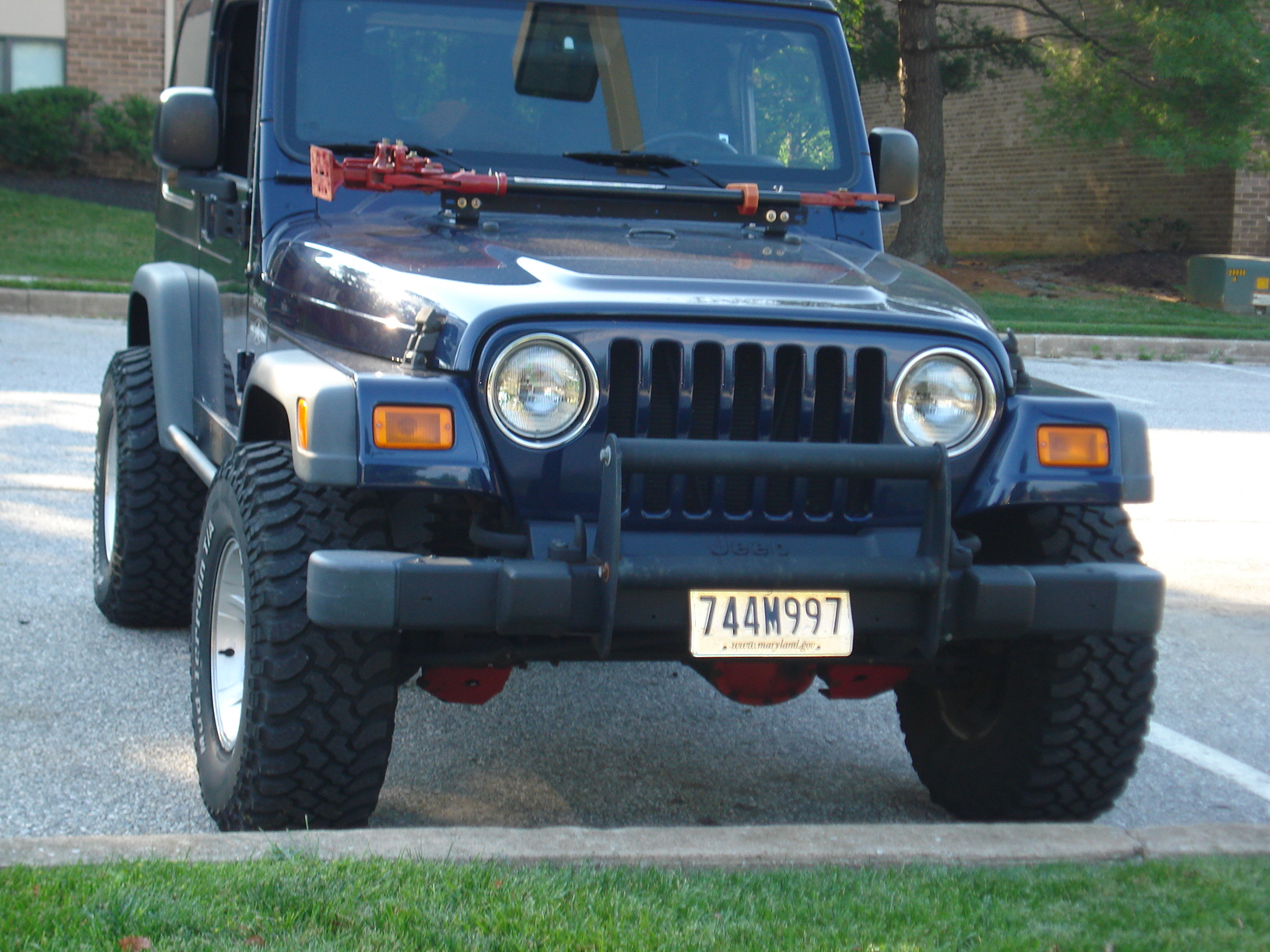

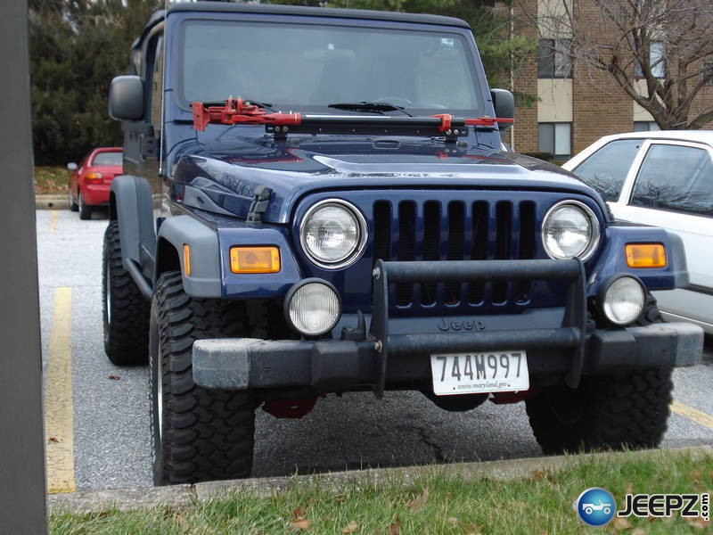

Here's a before/after comparison if anyone is interested.
