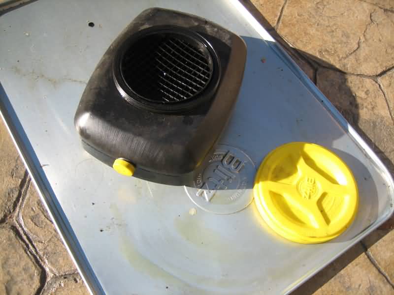

How to change the oil in a Jeep Wrangler TJ - Step 2

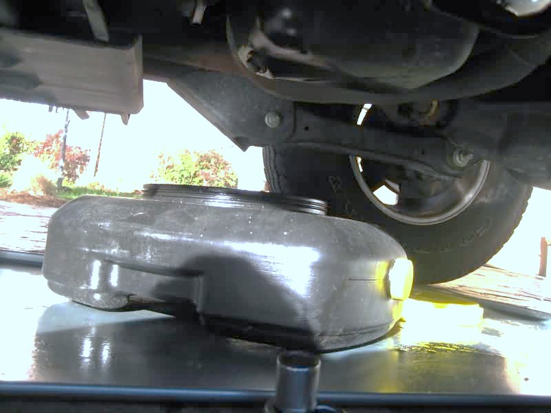

Next, you must arrange your pan. You can see from this photo, that I've got a large catch all metal pan under my oil drain pan. The plastic oil drain pan has a mesh on the top, that prevents things (like the oil drain plug) from falling in.
How to change the oil in a Jeep Wrangler TJ - Step 3
Attempt to position the pan under where the oil will come out

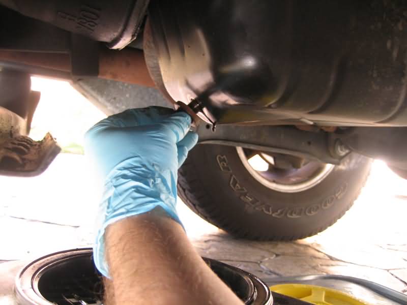

How to change the oil in a Jeep Wrangler TJ - Step 4

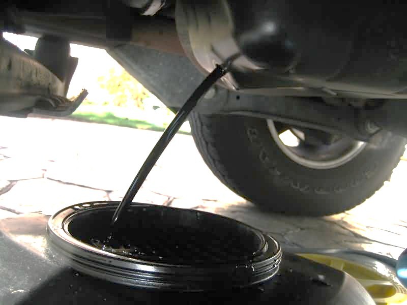

Now open the plug. You'll see that the oil comes out with a small amount of force, usually ending up somewhere other than your oil catch pan.

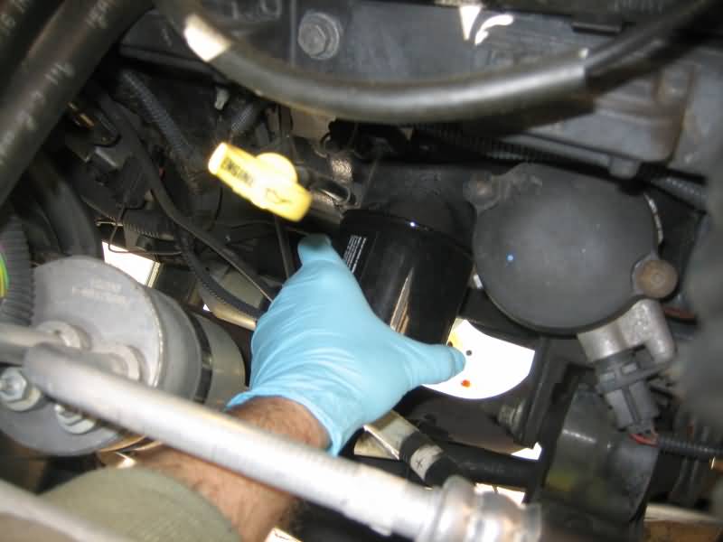

How to change the oil in a Jeep Wrangler TJ - Step 5

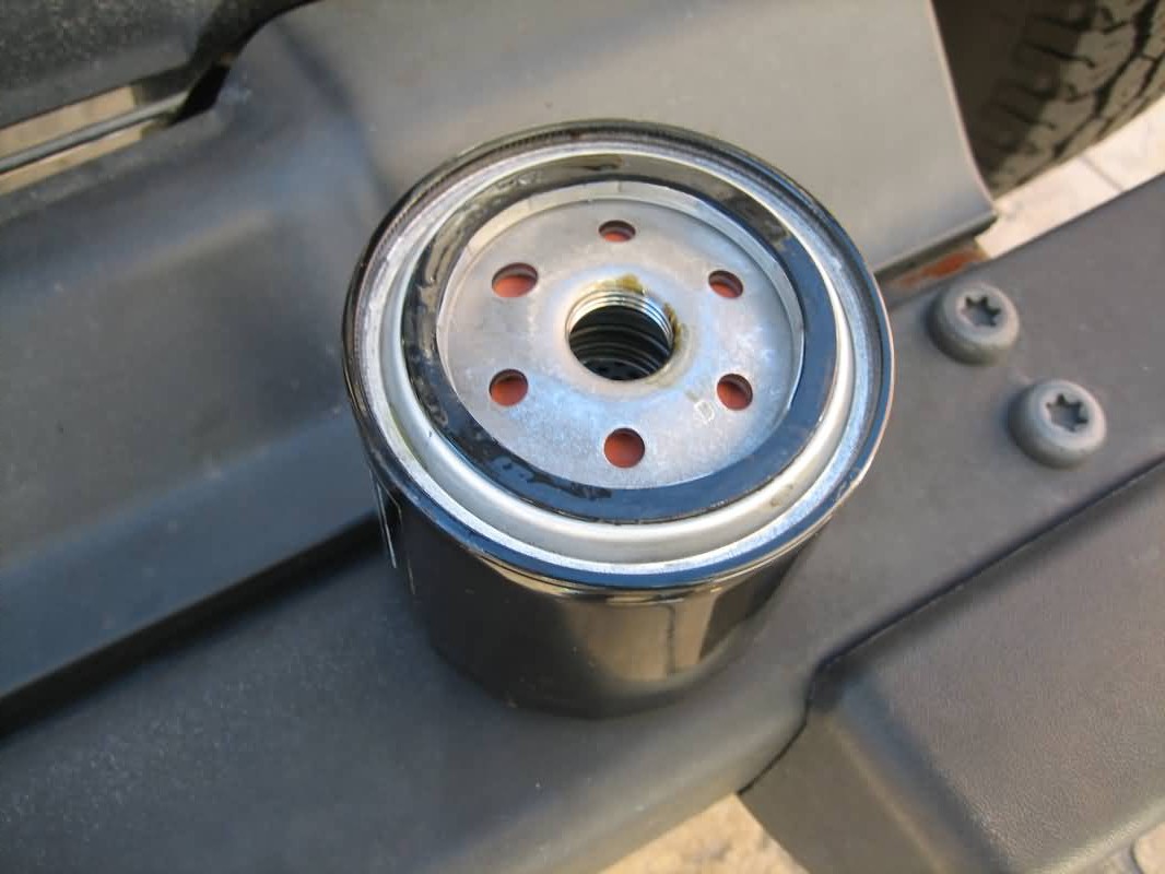

Now, you'll want to remove the oil cap (this may increase the flow out the oil plug, which is why we waited until now). Also, remove the oil filter. Hopefully, you can just use your hand to remove it - if not, use your oil filter wrench.
How to change the oil in a Jeep Wrangler TJ - Step 6
Now, you've gotten the old oil out of the system, and are ready to replace it with new.
take your new oil filter, open one of the new bottles of oil, and rub some oil onto the rubber gasket of the new oil filter. This will help the filter to seat properly.

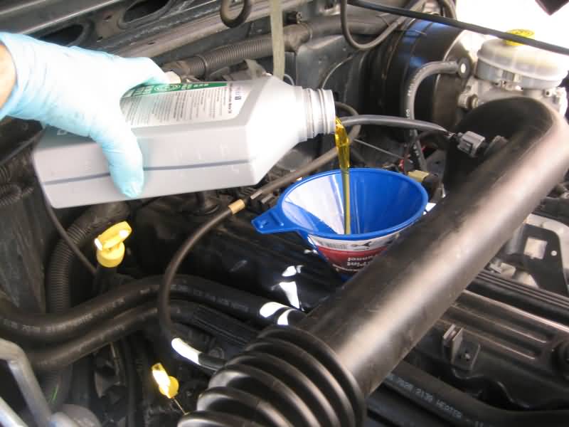

Now, you are ready to pour the new oil into your Jeep.
Just use a funnel, and pour in your oil, leaving it about 0.3 quarts low. You'll want to replace the oil cap, start the Jeep, and let it idle for a minute or so. Turn it off, and check the oil level - it will probably be low. Pour some more oil in, and repeat. We are going for 5 quarts for the 2.5L, and 6 quarts for the 4.0L, but we don't want to overfill the crankcase either.
