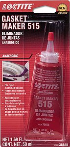

Locktite 515 is the best thing I have found for trans & rear ends. I work on diffs 4 times bigger & never had a leak on them or on any of my vehicles. (knock on wood) You can clean the surface from any oil you are putting it on then apply it. I have waited over 3 hours before installing the component & still worked great. It doesn't start to harden or set up until the air or oxygen is taken away. As in torque to spec. RTV is ok but it will rip a gasket if tightened to much or clog oil holes. I swear once you use this stuff that's all you will want. Just my opinion tho.
