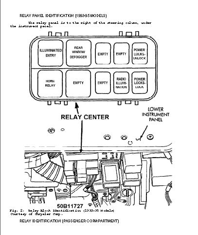

I have a 94 jeep cherokee, the horn is not working. I took the horn off and checked it with a battery and it works. So I figured the next and easiest place to look for the problem was the horn relay switch. Picked one up at auto zone for 12 dollars, but can not find where it belongs. There is supposed to be a relay switch on the lower side of the instrument panel, just right of the steering wheel colomn. Ok, found that but can not see as to where it would go, nor did I see any of the relays the same size as I purchased at auto zone. Any help will be appreciated. Thanks
the switch is in the pad on steering wheel,
the relay is located in the under dash relay box
. do not forget to ck fuses
