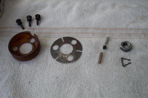

What spring are we talking about here? The one under the cup that the horn button snaps onto? Large falt spring? Like the one in this pic?
Mine will only go in one way and then the cup sits right on top of it with the slot for the horn button towards the top. Then the nylon insulator that is held in with 3 screws. There is a spring loaded post that touches the bottom of the cup, it is the hot for the horn. If it is being grounded the horn will sound constantly. That spring loaded post has to go through one of the holes in the large flat spring.

Thanks again. If I would actually look at the picture in the book, I would see the nice exploded view drawing and figure it out myself. Of course I found the jeep repair manual drawing after reading your answer and fixing the horn. Thanks again.
