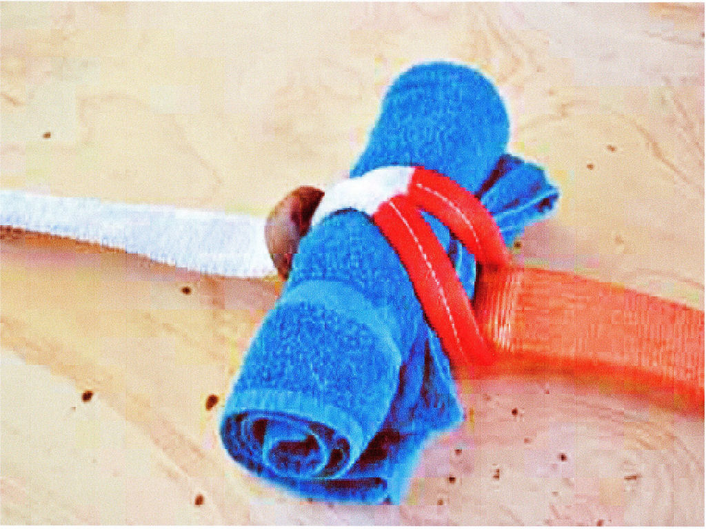

I suggest NEVER use a metal hook on a recovery strap, should that strap break, or the hook that is not 100% engagement slip, it becomes a flying projectile potentially causing damage or injury. there was a guy maybe three years ago out on the rubicon that was pulling a friend out with a strap with hooks, it snapped, ripped through the back of the jeep, hitting him in the back of his head killing him instantly.
Don't use metal hooks. Tow straps pack alot of power when they are under load.
I don't even think this strap had a hook, but imagine a nice 2 pound piece of metal on the end.
Do not use a shackle to connect two straps, it too will become a projectile should anything go wrong with the straps or a recovery point on a vehicle.
Feed the two straps through each other and use a light object like a stick or towel between the two loops, this will make taking the straps apart after a pull much easier.

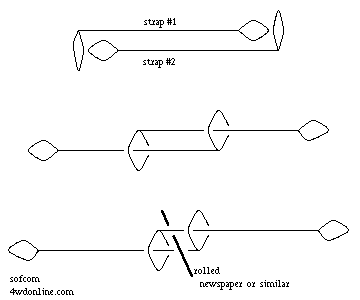

We dont avise the use of shackles to join snach straps or Tow ropes as these can also become deadly projectiles if a strap sheers. I have witnessed a number of straps sheer and seen the damage just a strap can do to a vehicle.
We use the following technique with a piece of wooden broomstick place in the loop
Remember to loosen the shackle 1 turn after tightening it otherwise it locks up. Also never use a tow hitch (ball type) as a recovery point as these are designed to sheer (caravan or trailor overturns). There was an Australian killed last year due to a flying tow hitch which sheered during a recovery
