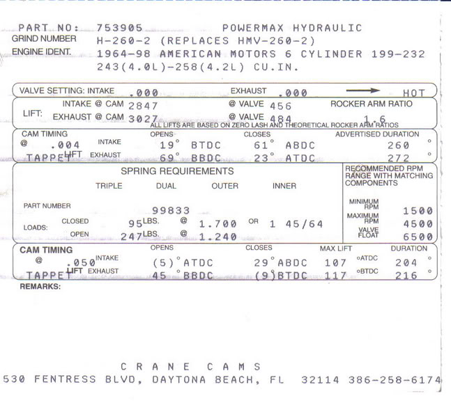

what are the specs on the stock cam...that one was an impulse buy... ...and i'm not really wanting to modify the rest of the engine just for a cam...

and the rocker arms...what is the stock ratio...1.5?would i have to modify the head to accept 1.6?
