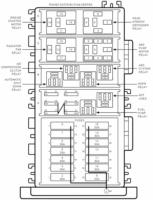

S southtj Active member Jun 26, 2012 #3 ...you could also check the fuse box for the ABS relay and fuse.
