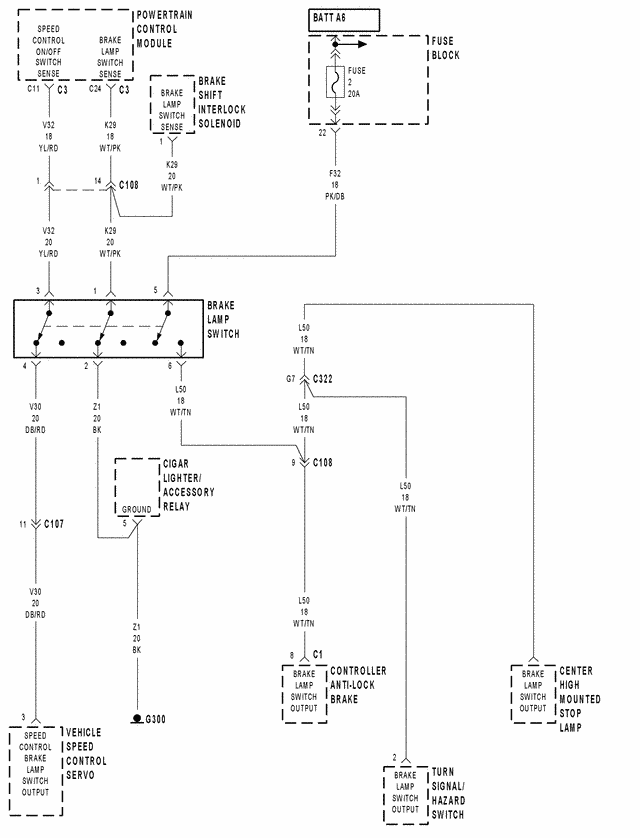

Sorry, Caffeine has not kicked in yet. Check the circuits on the Brake lamp switch. Follow the brake pedal up about past the mid-section and you will see the Switch. Here's the wiring diagram.

I agree if the fuses are good but all the brake lights stopped working at once then its the brake light switch. When you find it above the brake its an easy change. 1 nut 1 wire faster to unclip and its done.
