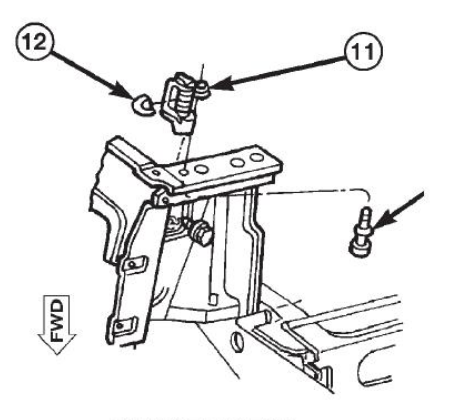

Ok so the power steering went on my 98 cherokee then it over heated so went to open hood to figure out what is going on and the latch/release snapped. Pulled the grill tried to pop the latch nothing. Any help on how to get this open I would greatly appreciate.
I always remove the bezel and headlight, then the headlight buckets, then unbolt the hood catch right and left. It may be a little different for your 98 with the newer style header/grill. But the latch and catch mechanism is likely the same or very similar.
