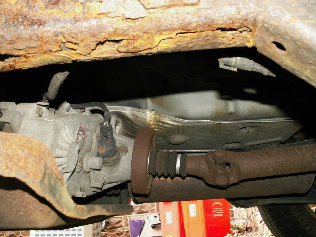

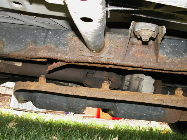

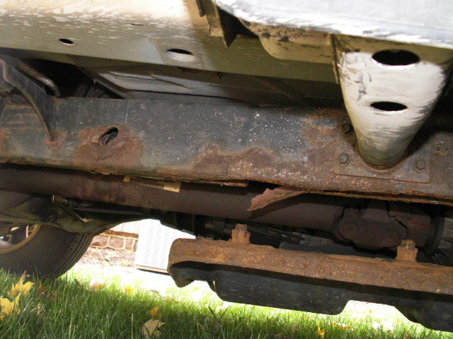

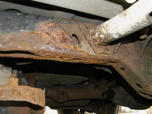

I just typed this long post and it disappeared! Grrrr. I will try to make it shorter. I still have my 2000 Sahara.. in nice shape ( or so I thought). Last month or so it's been wobbly and feels like the butt end is dragging. I was actually wanting to trade it in for a newer Jeep. My husband wanted me to take it to our garage and have them check it out, not wanting to give my problem to the next person who drives this Jeep. I go to the garage today and John our mechanic drives it. About 10 minutes later he appears in the doorway with Kim, his wife. They ask me how long I have been driving it this way and I say a month. They both gasped. Turns out I won't be trading this beauty in after all!!
They tell me my frame is totally rusted and the bar? that runs crosswise underneath isn't even connected on the one side!!! My drive shaft? and transfer case are dangling by a thread...down in a V shape... and the can't believe its even driving and I am SOOOOO lucky I didn't crash!! So they say it needs a new frame....and I may want to sell it to someone who knows how to do it.... and may want a Jeep that's nice except for its entrails hangin' out!!!
What do I do? What would YOU do and what would Jesus do?? HA. No, seriously...what do I do? Are there people who will buy this and repair it and want it? It's not hogged up.. it's a nice one. It was towed back home and I cried and cried.
You can look for a used frame, sounds like yours might be beyond repair. Some frames can be repaired if not too far gone.
You can sell yours outright as long as you disclose the issues and you're willing to drop the price drastically. It's only good to someone who is willing to put in another frame or wanting to part it out.

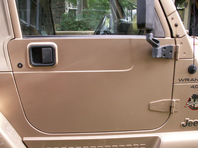

If you could get $1500 for your Jeep as is with no work done then I'd take it. If your Jeep has a hardtop and hard doors then I'd sell them separately - you may get $1000 for just those.

It does have a hard top.. and full hard doors. I also have full brand new soft doors in zippered cases that were never used... and a soft top that is in okay shape. I will run it by my husband later and see what he thinks.. he doesn't really care, although he is very cheap. HA. He may tell me to sell each and every part one by one including that pesky fan blower knob that constantly breaks. Surely we could get a buck fifty for it. :)

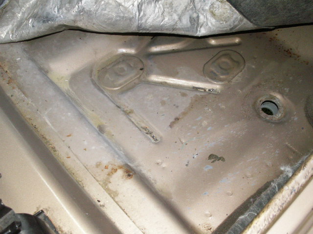

My hubby and I were outside checking under the rugs for any rust and we both just stood there in silence. He said this is the saddest thing I have ever seen..this Jeep is so nice...in fantastic shape...if I had a lift I would try to weld it and fix it. I said it's ALL YOURS!!! Seriously though, the thought of raping this Jeep for parts brings a tear to my eye. It's really a neat looking Sahara. No dents no dings... nice tires and wheels............. I have to go get a tissue!! I was hoping someone would want it to just re-frame it and have fun. But whatever... it is what it is. Maybe I will list it on Craigslist tonight and see. I guess money is money and right now I am driving a 94 Cherokee and it's seriously Chitty Chitty Bang Bang.... or Uncle Buck...whatever generation you are from. I am in PA by the way...about 45 miles west of Philly... feel free to stop by with some cash!! :)
Where you located? And what about some pics? The repairs could be done and get low if you were not worrying about an exact factory look at the repairs. Sounds like a perfect off road toy to me.
here in Cali I could get an easy 4K parting it out. Although, in reality, I would repair it or replace the frame. It's not that difficult, just time consuming. Best of luck to you.

I said maybe 3 weeks or so I've noticed it. I thought it may need an alignment. Well, to my surprise they informed me that my ENTIRE undercarriage is totally rotten AND the support cross beam underneath is broken off on one side! My drive train and transfer case are literally dangling out and ready to drop on the ground!

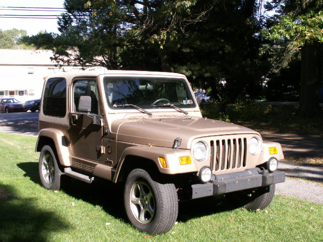

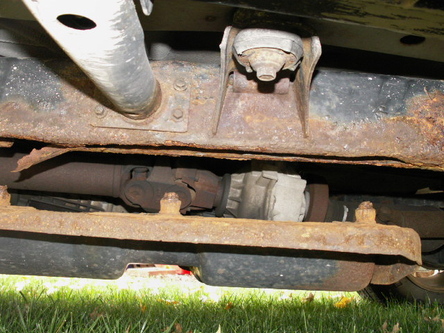

I sure would like to see pictures of it and what not so others can inspect their jeeps.
I will attempt to upload my pics here.. of my beloved Jeep.

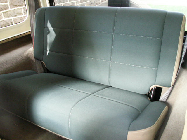

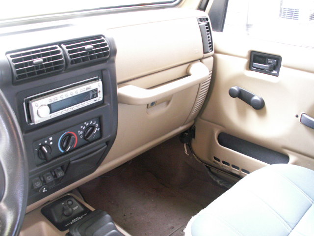

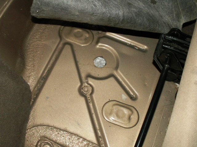

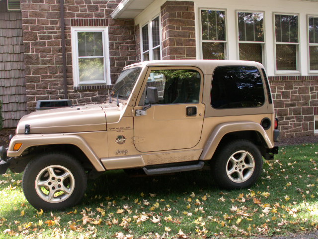

You can see that this is a GREAT Jeep, except for the ass hanging out.. it's got no dents, no dings, fantastic interior.. good floors, sound bar , add a trunk, etc. I hope someone would want it to repair it? It makes me cry to look at it.
