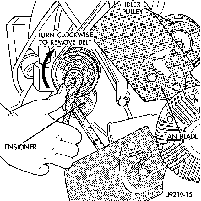

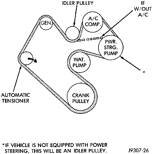

SteelHeadz said:One way to verify on which one of the pulleys that could be making the noise is to remove the serpentine belt. Spin each one of the pulleys and see which one is loose, rough when spun or partially locking up. To remove the serpentine belt, follow the diagram.
