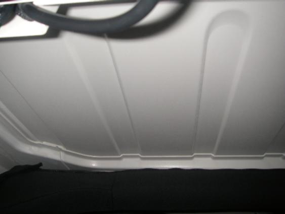

Last summer I felt a ton of heat coming off the inside of my hard top so I came up with this fast cheap fix.. In Florida we have a ton of heat and sunshine one day I all most burnt my hand on the inside of my roof. As I took down my windshield visor it was cool to the touch that is what gave me this idea!

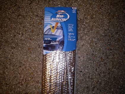

Start with 3 jumbo windshield deflators.

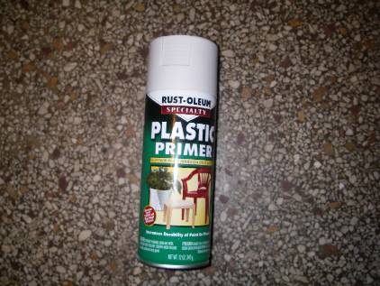

Than spray them with Rust-Oleum Plastic primer you pick the color! I used white.

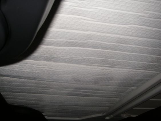

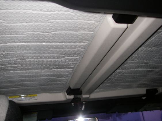

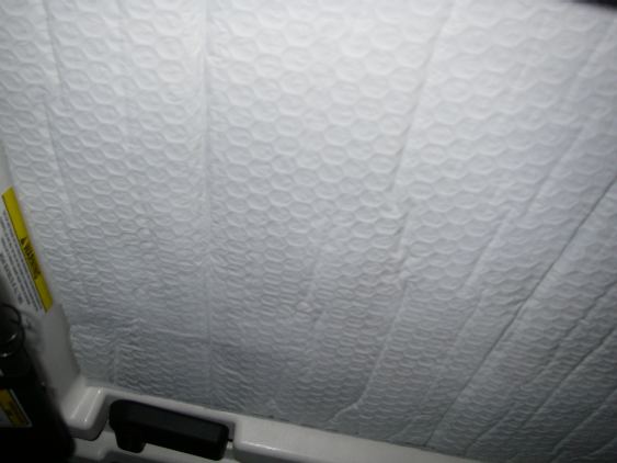

Repeat to all 4 pieces and your done! I have had them in for about 3 months now and no more heat beaming me in the head and the Jeep cools off fast now!
Driver side tee top.
Front tee tops.
Back seat top.
