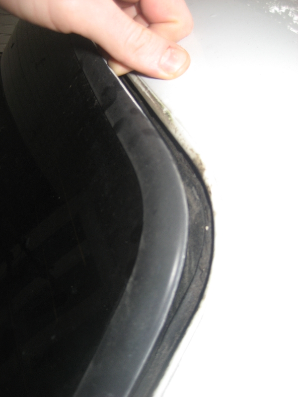

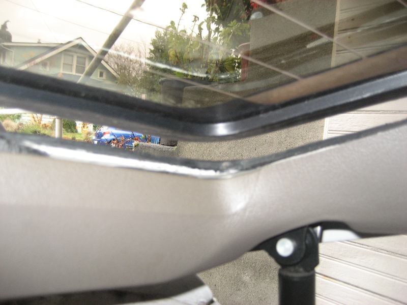

I put too much stuff in the back of my 1994 Grand Cherokee and the rear windshield popped out when I closed the hatch (window is fine). It looks to me like it is just a gasket that broke (it is almost 20 years old), but I wanted to see if anyone had dealt with this before in case I was missing something.
Any advice on where to get a gasket would be helpful. I've tried the local parts shop and they said they can't get anything like that.
if the gasket aint broke and its still in one piece you should be able too putt the glass back into it use some soapy water and work it on the put it back in the frame start at the bottom and use a couple screw drivers i did this with my 85 chevy
