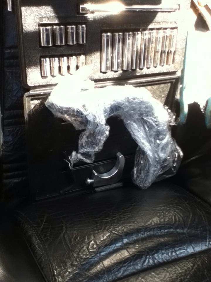

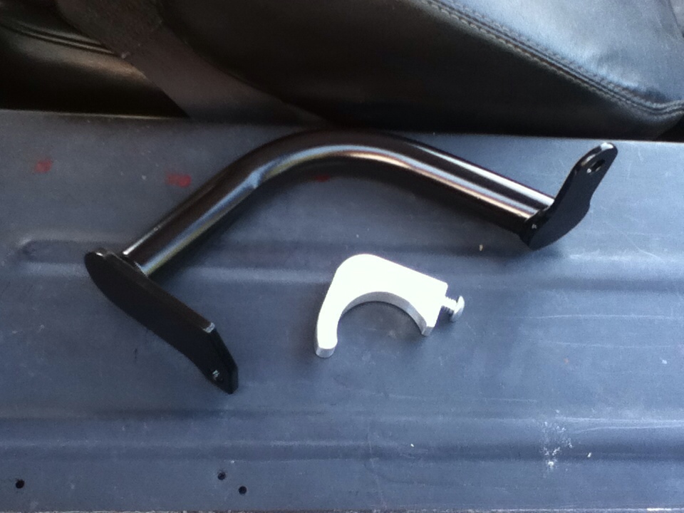

they come in a standard cardboard box and are only 3 pounds or so. ups said they were due tomorrow but they showed up a day early. inside the box they are wrapped in plastic wrap and packaged in peanuts with picture instructions.
here is a shot sans wrapping

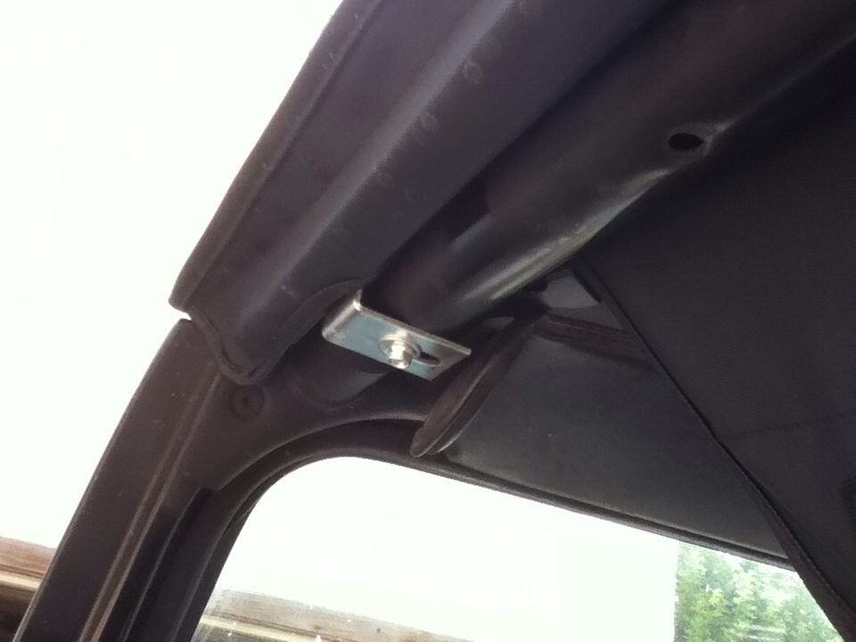

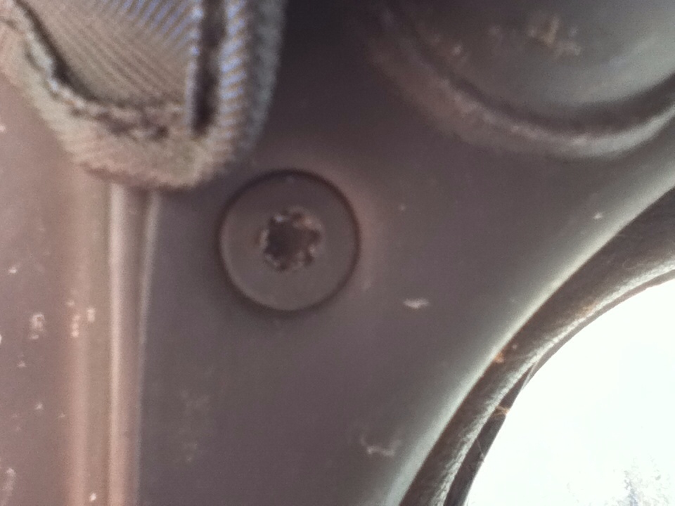

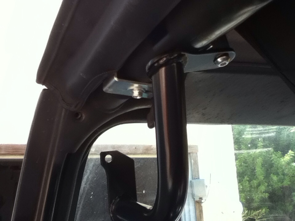

they bolt in using this lower windshield bolt and the back end wraps over the header bar.
beware of stripping out those stupid torx bolts. that factory bolt is something like a t30 or t35 but since i rounded it off, i used a little larger one and a hammer to get that stupid thing out.
you install the grab handle finger tight and then tighten up slowly making sure the aluminum clamp stays solidly around the header bar. it uses an allen wrench that i failed to check what size it was.
when you get htem clamped and tightened down, you can rock the whole jeep with it, easily

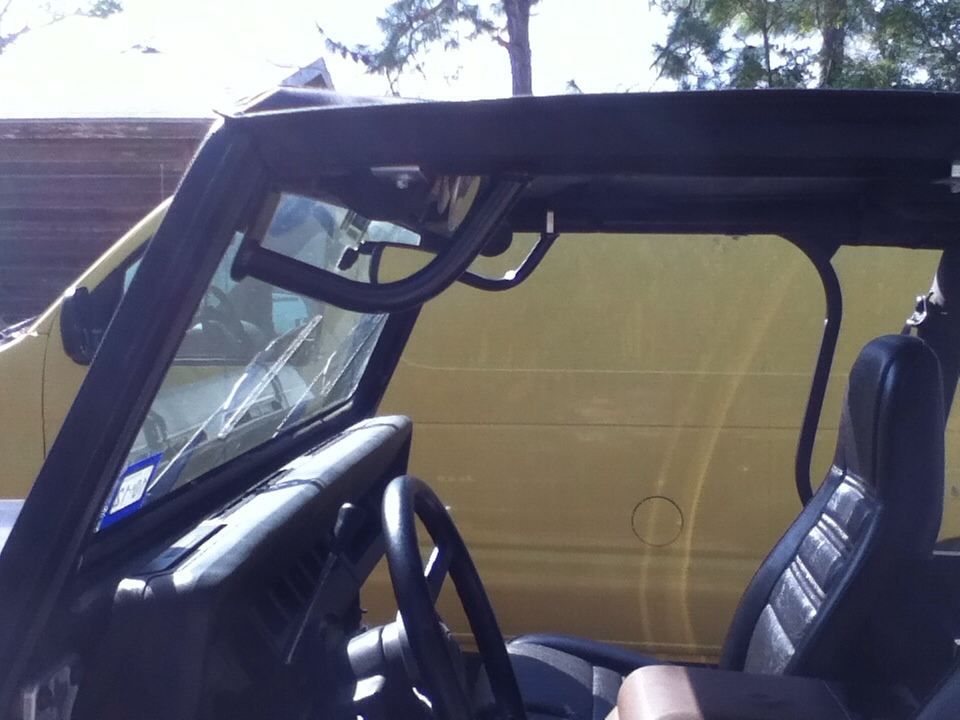

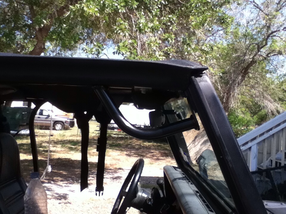

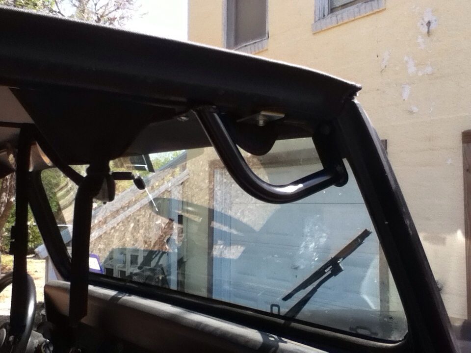

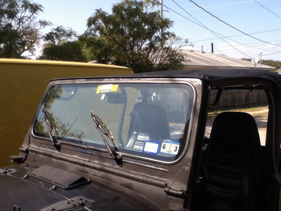

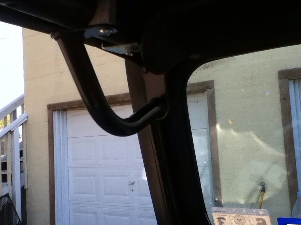

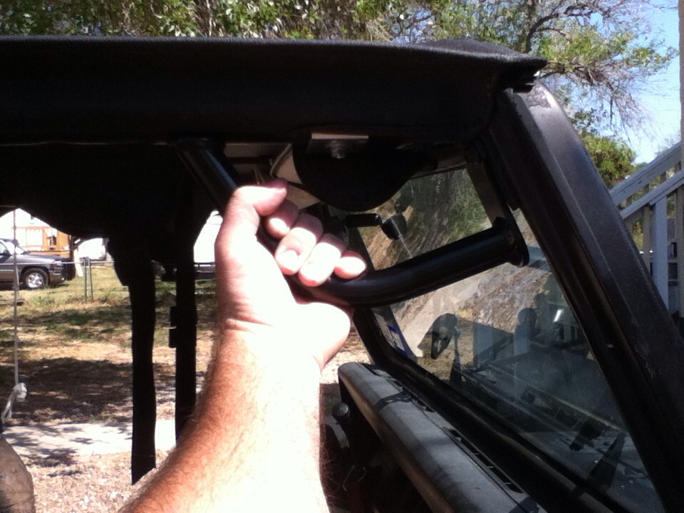

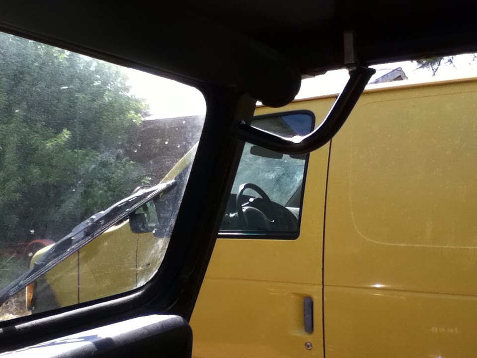

here are shots from different angles for you guys viewing pleasure
i really like them. you can hang your hand on them while driving and when you are climbing in, they do not move or swing around. cristina said they are very nice too as she was the one complaining about not having something to grab while getting in the jeep.
i like them.
i find myself using the one by me while driving just to rest my arm. i loosely hang my fingers and arm while cruising so i am not leaning in my center console when i am relaxed driving. hopefully, that helps with my elbow hurting from the doors when they are on too because i always have my arm on the door and since sometimes i do long bouts of driving, my arm would get sore and numb from the elbow area. this should prevent that issue.
