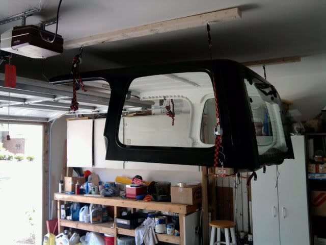

I was shopping for a soft top jeep and came across a great deal on a Jeep that had a hard top and the soft top had never been used. I was looking for a soft top because of a lack of storage area for the hard top. We keep my wife's car on one side of the garage and two kayaks on a trailer on the other side. I was not going to move either of them outside.
I did some searching and found several options. I chose the simplest. I can always add a pulley and/or winch/motor system later.

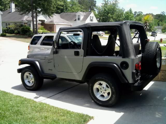

The jeep is below; with the soft top on it.

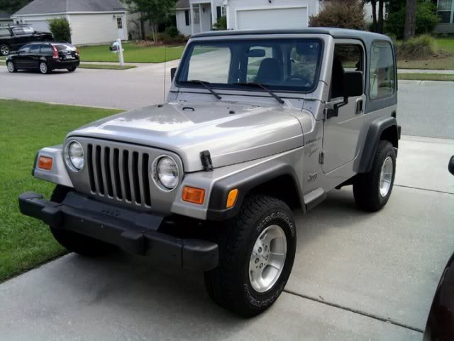

Hard top

Did you buy a kit to do that? Looks like three 2x4's and 4 cargo straps. Can you still back the jeep under it? I'd like to do something similar, but I need to be able to keep the jeep in the garage.
It is just 2x4s (1- 2x4x10 cut in half at the store and 1-2x4x96" cut to 62" at home), cargo straps, and screw eyes. Everything was 48.43 at Lowes, including a can of black Valspar Plastic paint for the flares (another project).
You can't see it, but there are two carriage bolts sticking up through the lower 2x4. They go in the holes that mount the top to the Jeep. I used the lift straps to lift the top off the Jeep. Then, after the Jeep is out of the way, I mount the board to the top, lift the top and move the hook from the top to the eyes in the 2x4. Then I lift the top by walking aroun and taking up the straps a little at a time.
I did have to shorten the standing end of the cargo straps and re-sew it with upholstery thread. If I had purchased hooks instead of eyes for the front, I could have just slipped the looped end of the strap (where it attaches to the buckle) over the hook and been done with it. I need to move one of the boards back a couple of inches to hit another stud. When I do that I may replace the front eyes with hooks.
I don't know if I can back the Jeep under it for parking (of course, I can back it under for top re-install). I am pretty sure I can nose the jeep under it. YMMV, due to your garage height and lift kit/tires you may have installed on the Jeep. I don't park the jeep in the garage due to the kayaks and trailer. They fit under it fine.
If I find myself removing the top often, I'll change it out for a winch system. If it is just a couple times per year, this should work fine.
