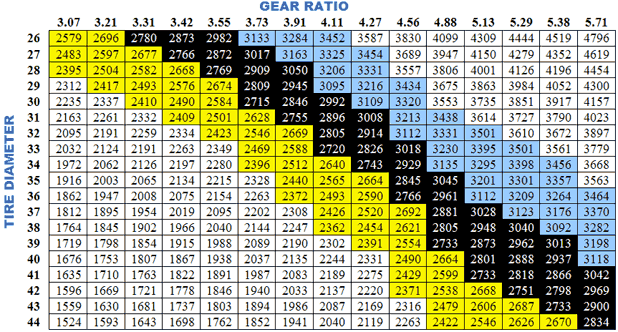

Check out this chart to help determine what axle ratio you should have. I recommend finding the RPM for 3.07 gears and 27" tires, then find a similar RPM for 35" tires. That's your new recommended ratio. I always go a little lower (higher numberically) with gears than recommended.

That chart is good for an automatic with this caveat:
This chart is based on 65 MPH and a gear ratio of 1:1, on a manual transmission in 4th gear. Please NOTE: If you have an automatic transmission your RPM will higher due to slippage in the transmission and the torque converter. With an overdrive transmission your RPM in overdrive will be 15% to 30% less than indicated.
from here:

That's chart is for manual I have an automatic
Doesn't matter. Find the RPM for your stock tire size and gear ratio. Then work your way across the 35" row until you find a similar RPM, that's the proper gear ratio for that tire size. Regardless of transmission type.
I recommend going one ratio lower (numerically higher) than recommended. This will greatly improve performance on road and off. Regearing only compensates for the added tire diameter of larger tires, but does nothing to compensate for the added weight and rotational mass. For this reason it's best to go a bit lower.
im with jester32, 4.56 to 4.88 would be good. I am running 4.88 with a v8 and 4spd trans and my rpm on the highway are right around 3000 rpms, I dont have a speedo so Im not sure how fast I am going but I would say around 55-60 tops. I had a overdrive in the jeep and with it on the highway the rpms were around 21-2300 if i remember correctly running with traffic. Your auto will not require as low (numaricly higher) of a gear as the converter will compensate for a slightly higher gear, where as a clutch would slip alittle, but I would still go with at least 4.56. probably a poor explanation for a gear change but heres one way to look at it, If you have a 30" and a 35" tire and put them side by side and roll them one revolution you will see that the 35" tire traveled a further distance than the 30" due to its larger diameter. This takes the engine out of its normal operating rpm band, (lowers it) so a gear change will put the engine back in its normal power band. Its sorta like driving a stick shift car in one gear too high at all times vs driving it in one gear lower all the time, it raised the powerband, (rpms)
