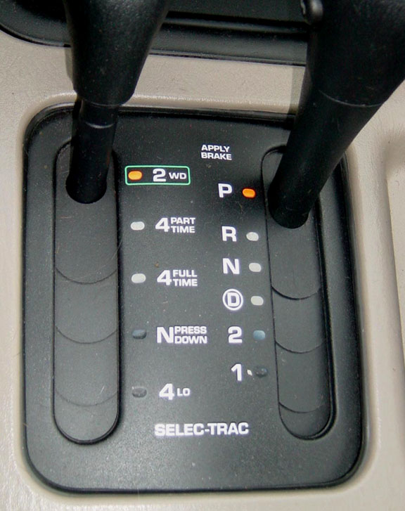

I am guessing a select trac NV242?
If so did you try to use 2wd? Sometimes T'cases get 'stuck'* in 4wd - shifting to N or reverse may unload Tcase from the current position .
*Torque locked would be a good description

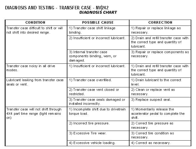

trying to help if this Is slect trac NV242 confirm..... use wd40 when checkg cable and linkage movement
