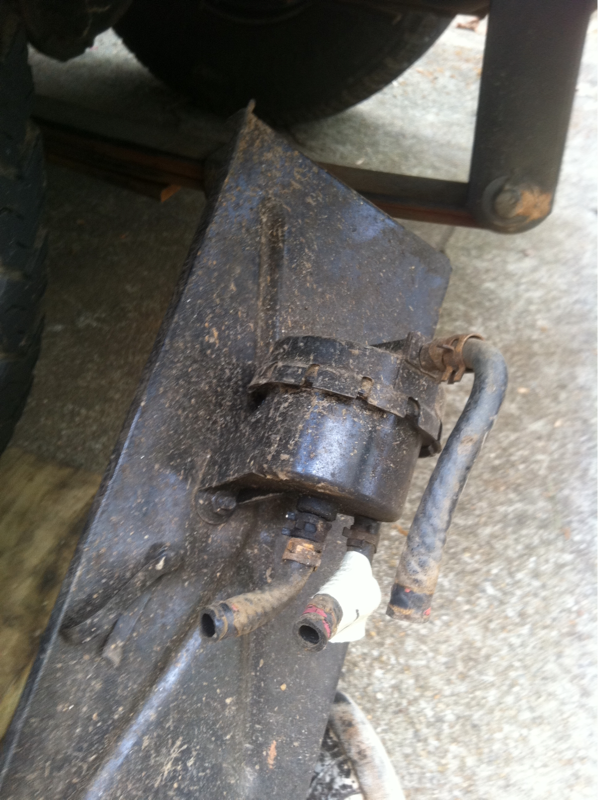

So when going about doing it the right way I found this. It kind of looks like a fuel pump but there's no wires. Anyone know what it is? Maybe just a filter.
That device is your liquid check. The 2 lines on bottom go to the fuel tank vents & the other goes to the carbon canister to recover all those precious fumes.
