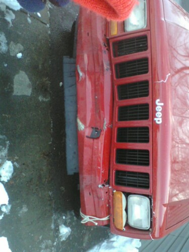

I own a 2000 Jeep Cherokee 4x4 4.0L and got into a minor accident. The front bumper and grille is bent in and cracked. Is this a repair i can take on myself or would there be an underlying problem with the frame because it may need to be straightened. I'm pretty sure i can easily find the parts at a junkyard in the Northern Virginia area. any help would be greatly appreciated.

There is no frame on an XJ.....your best bet is to pound it out and keep on rolling.
That's not so bad at all. Replace the bumper and grill and maybe a few brackets but its not bad really.
Ya not too bad at all. See Cherokee dont have a body-on-frame build or a uni-body build, Jeep called it the "uni-frame" so ya just replace the front bumber, little brackets and such and you'll be good to go!
