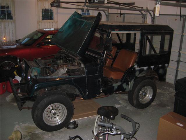

priorities are difficult cuz the body needs some work as well. there's some parts like this right rear panel that would be cheap to cover up, but probably better off if i just get a whole new back tub (fiberglass most likely)

and the windshield frame will definitly have to be replaced cuz the 2 ducts are now 1 hole due to rust

Start with the Electrical and Mechanical issues. Once you get them going, the body can be done a section at a time.
Must admit he looks pretty at home in that seat! Dont sweat the winshield frame they are inexpensive and dime a doz, glass on the other hand...not sure if we're aloud to post links up, but Ive got a few good suppliers I use for my 65. Pm me if your interested. T

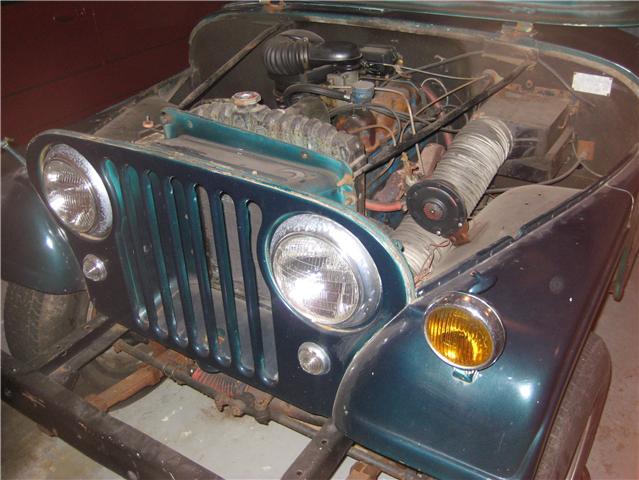

upon removal of a lot of components i've decided to completely replace the tub with a new fiberglass one. the steel one on there now is too much into disrepair with rust, drilled holes that aren't used for anything, terrible welding jobs, etc

so far i've broken down the hardtop, taken off the dash panel and it's components, removed the blower motor, and multiple other tidbits. there are some strange looking weld-like spots that close some of the fender gaps so i hope i don't have to cut too much stuff. the front fenders and hood are just fine, very few tiny dents.
