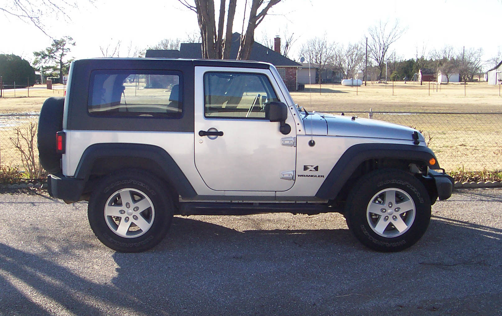

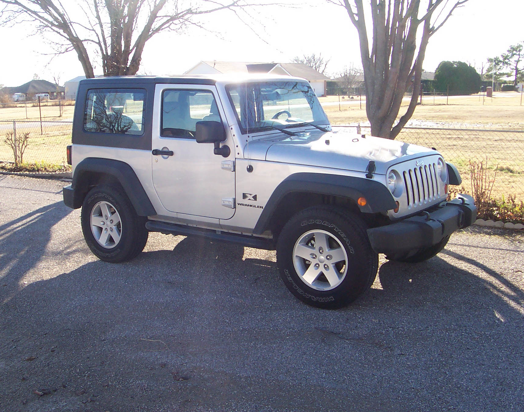

I have a 08 JK. I'm not gonna be rock crawlin, mainly mud and sand. My questio, I have the stock 255/75R17's on it, what is the largest tire (width & height) I can mount using the stock wheels and without lifting (or w/ minimal lifting). Thanks.
