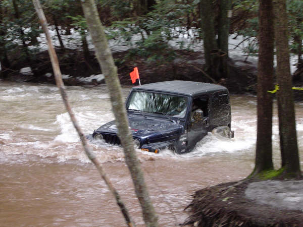

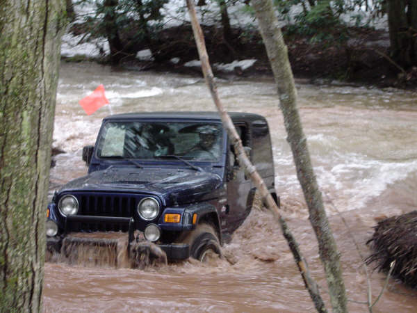

Let's say, hypothetically that I drove through some water...(see pics below)
Well, what fluids as far as transaxle oil, diff oil, etc should I consider changing?? Can somebody recommend a brand of gear oil, and also tell me what quantities and weights of oil go where? Could I find this info in the owner's manual?
I actually drove through that water 4-5 months ago, but I was unaware until recently that I should have changed my fluids. I don't know of any damage this may have caused, everything seems to be running fine but I'm getting a little paranoid now. If anyone can give me some info I'd greatly appreciate it.
