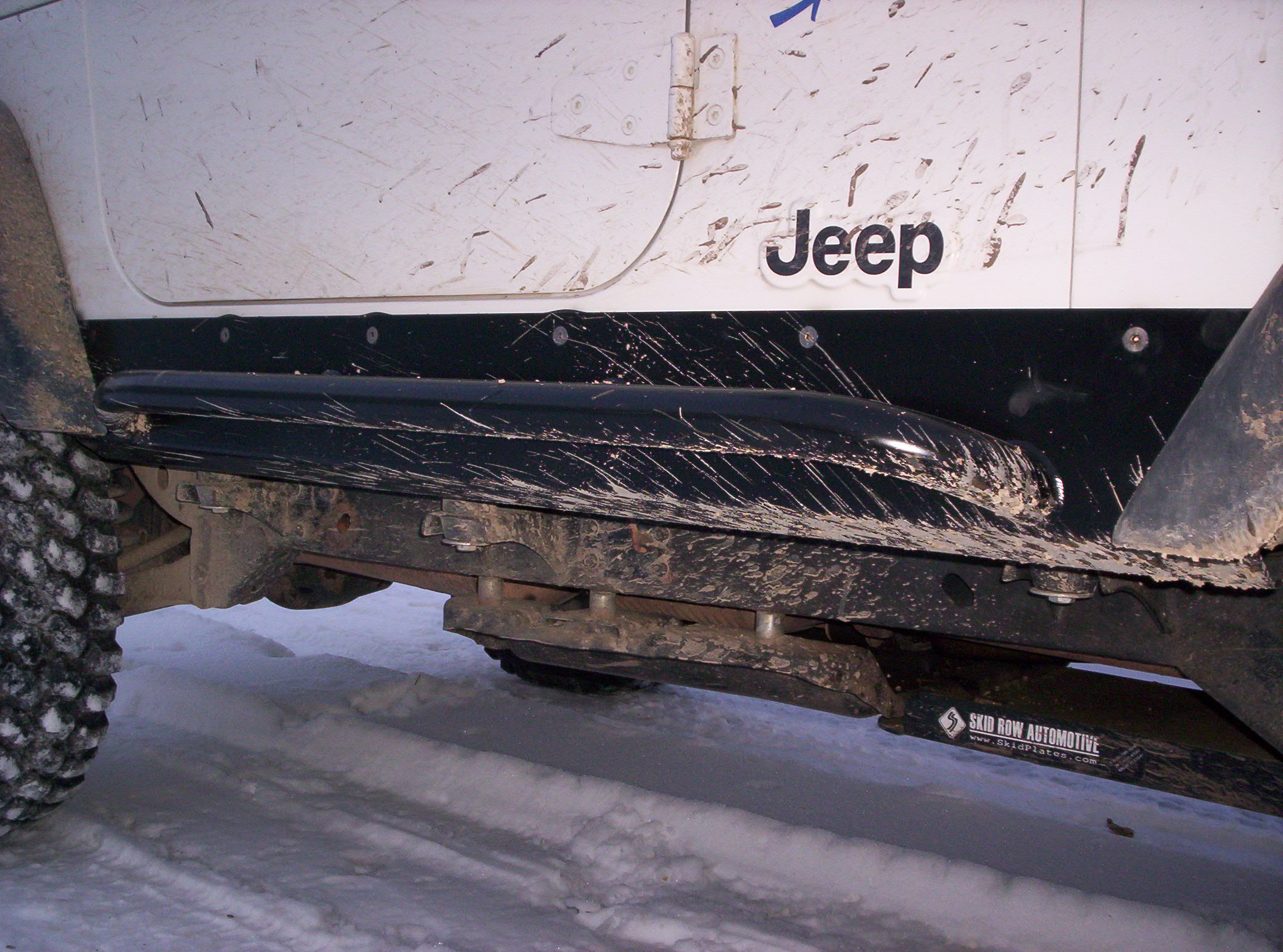

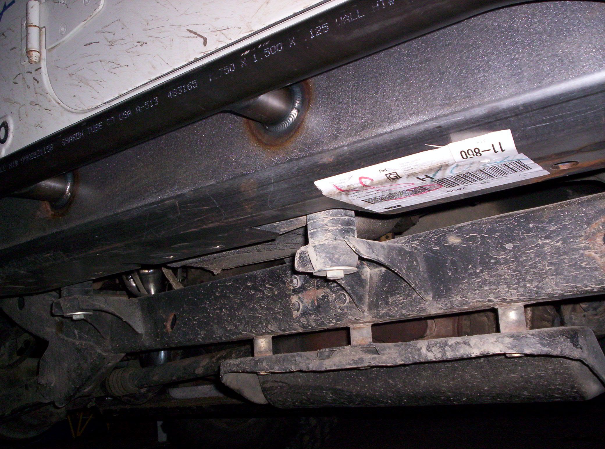

Well, if I did this right(please!please!please!) here are some pics
woooohooo! It worked!! (thanks for the help, Terry! ;))
Sorry I couldn't have got a picture of them before I drove down our dandy county roads.
The install was straight forward and very simple to do. They are heavy so it would be a plus if you have someone help you. Floorjacks are a BIG help.
See the Fed-Ex sticker on the bottom of the skid in last pic? Yup, that's the way I got 'em. Wasn't to happy about that, had some scrapes on the bars from shipping, but not to bad. Paint seemed to hide them fairly well. Other than that, so far (haven't had a chance to try them out yet!) I am very happy with them.

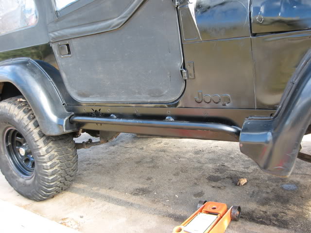

I like my poison Spyders but I am going to add an additional bar to them soon.
I just have to bend the tube, weld it on and paint it. I will admit that I will either add bathtub tape of put sand in the paint for the final coat...
Use the grip tape. Sand in the paint will quickly wear off. Grip tape will wear out too in a few years, but it's easy to replace. I have also seen people cut thin strips of expanded metal and tack weld them to the top sides of the bars for foot traction. It probably works the best, but not very attractive.
Use the grip tape. Sand in the paint will quickly wear off. Grip tape will wear out too in a few years, but it's easy to replace. I have also seen people cut thin strips of expanded metal and tack weld them to the top sides of the bars for foot traction. It probably works the best, but not very attractive.[/QUOTE
I hope to get some grip tape tomorrow. Thebars are a little high for a step, but better than nothing. My youngest daughter still has a heck of a time trying to reach that first step!
