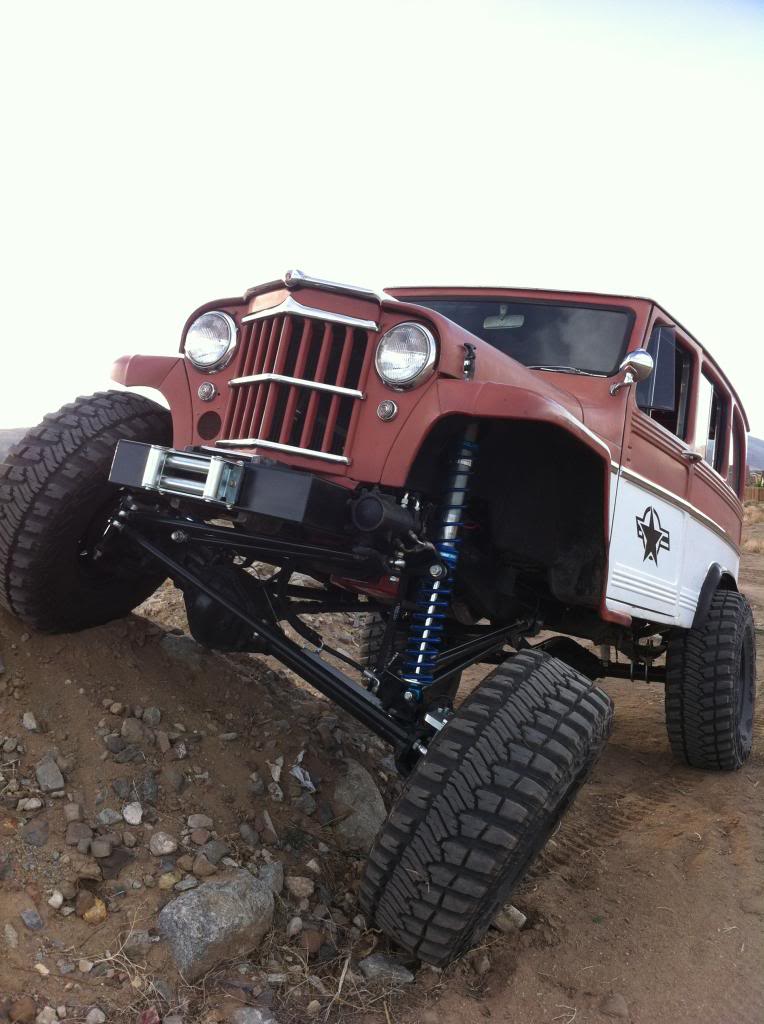

No, far from stock on this Jeep. It's a 1961 Willys wagon on steroids !

Very cool. Post up some of your mods, and more photos if you can. This would make a great build thread (i.e. detail what you started with and how it's built now.
1961 Willys wagon, 550 h/p 383 stroker with 11.3:1 compression,built TH400, d300 w/4 to1 gearset, twin sticked. D60 front with 4 link and King coilovers, 14 bolt rear on leaves. 38x14.5x17" MTRKs, Disc brakes on all 4 w/Eldorado calipers on the 14 bolt for E brakes. PSC hydro assist and hydro assist brakes. MSD ignition.The body is on a K5 blazer frame. The front frame horns were cut off and rebuilt to hold a winch, and it was boxed and raised about 6". Full compliment of Autometer Phantom Gauges. ARBs and comp. in garage waiting their turn. Still need skids, cage, some wiring, and I have a winch waiting also. It's been quite a build as no one makes bolt on anything for this. It is a real blast to drive, to say the least.BTW, I also have a pretty well built JKUR but, who cares about it now ? lol !

Thank you, It is a lot of fun but, no beauty really. The paint is so faded, I think it used to be red. There are some dents and some rust but not bad and fixable. I don't want to fix and paint the body because I wheel it and don't want to wonder why I did all that work just to screw it up. I know other Willys owners who would never take them off road. They think I'm nuts. likewise I say ! lol
Your jeep definitely is a keeper. Looks really awesome thumbs up for you!
