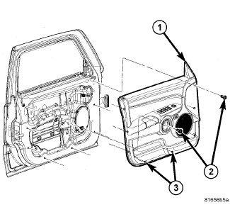

1.Disconnect and isolate the battery negative cable.2.Remove the three screws (2) that secure the front door trim panel (1) to the door.3.Carefully pull the front door trim panel far away enough from the door to disengage the seven plastic door trim panel retention clips (3) from the door.4.Lift the rear of the panel upward slightly to disengage the interior door latch lock link and knob from the rear of the door panel and the inner belt seal.5.Lower trim panel and separate the trim panel mirror flag from the clip.6.Disgard the mirror flag clip.

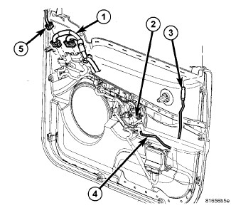

7.Position the front door trim panel far enough away to access the door wire harness connectors (1) and the interior door handle actuator rod (3).8.Disconnect the interior door handle actuator rod from the interior door handle (4).9.Disconnect the wire harness connectors (2) from the power door switch assembly.
