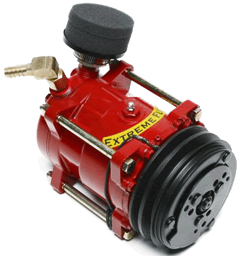

I just finished installing an Extreme Air Compressor on the Mighty YJ...
The manufacturer picture (they don't paint 'em red anymore)-

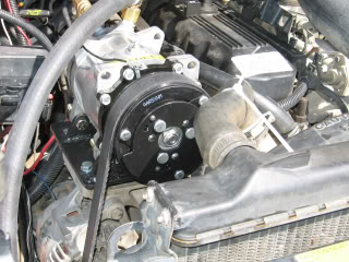

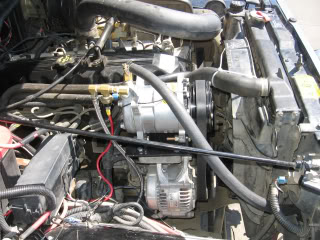

Now installed under my hood -
It was a fairly easy install (I never thought, prior to owning a Jeep, that I would say anything like that). The problems were finding the right size serpentine belt to use with (the third was the charm), and I will have to reroute the upper radiator hose (Notice the nylon tie).

There is an oiling port on the top of the compressor. It is a monthly task. You can see it in the middle picture.
It fills my 33" tires in about 40 seconds each. I generally air down to 10 lbs and air back up to 29 lbs.
I already had a break down this afternoon. Trial runs can be so trying. In the middle picture at the back you can see the wrapped metal jacket tubing that heads down to the air tank. The fitting on the back gets hot. That plastic tube released a lot of air suddenly when it blew. I replaced it with 3/8" copper tubing with compression fittings at each end. I even curled the copper to increase the cooling factor. It is much cooler now by the time it gets to the air tank even with the hood down. I want to be able to keep the hood down so people don't stop to ask you if you need help.
So far, its holding and keeping cool (and it looks pretty boss).

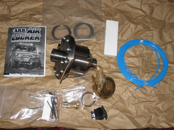

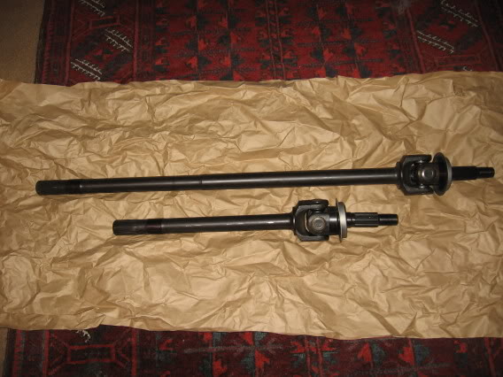

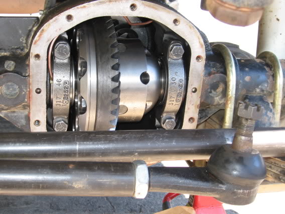

I finally got the ARB air locker and the Dana 30 30 spline chrome molly axles in the front.
That was a fun project also.

These are the new axles...
Here is the ARB kit...
Finally field tested it yesterday. Worked great.
