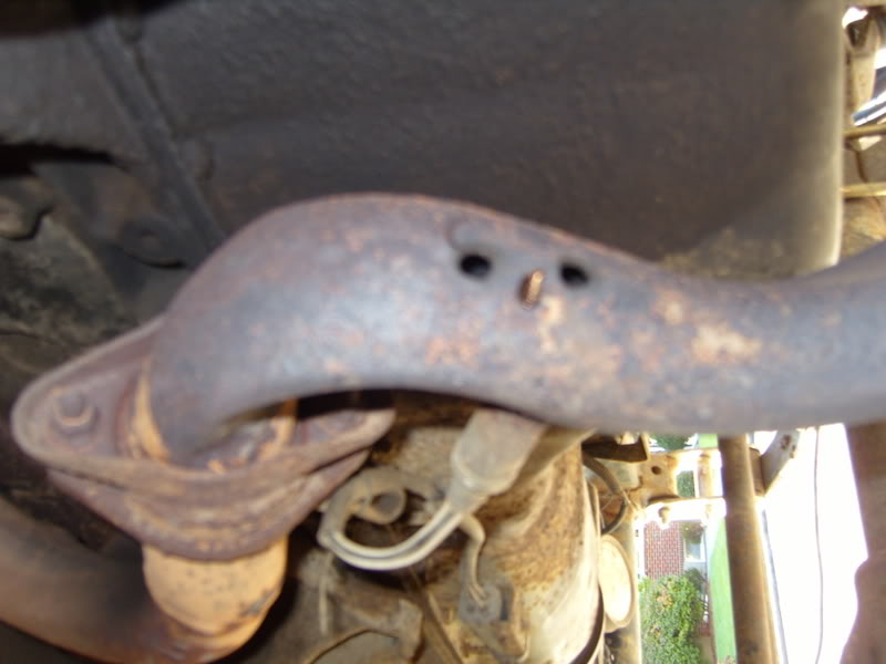

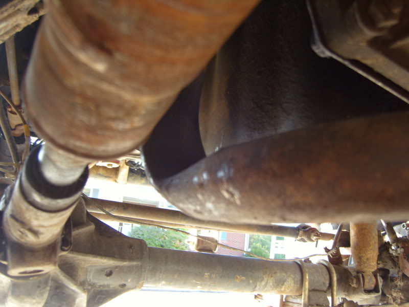

Here is what my down pipe looked like after a trail ride couple weeks ago. The S bends turned into Z bends, which is why my jeep would not stay running.

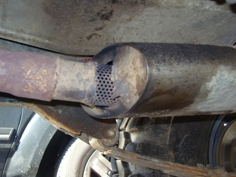

As you can see, I didn't have time or desire to fix it properly for a fall comp event (which was the following weekend) so I just drilled a bunch of 5/16 holes just after the manfold flange, had that real nice big block sound :

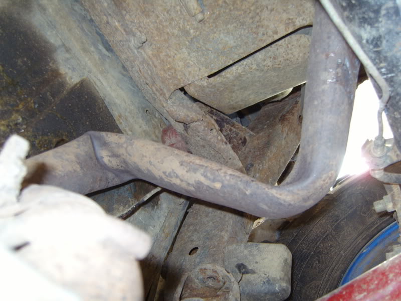

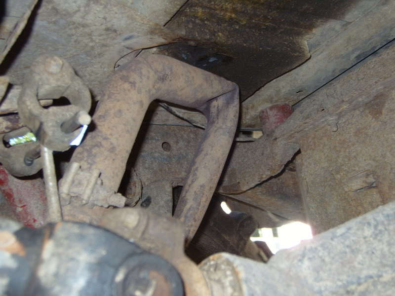

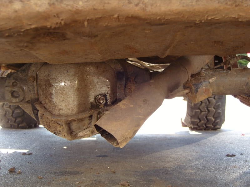

and here is what I did to it at the fall comp
so I might need new exhaust :-\ my manifold cracked real bad about 3 years ago and I bought a header and down pipe from Banks then, but never installed them. I am now going to install the header and sell the down pipe, buy some universal exhaust tube from summit or jegs piece and together a custom exhaust in the end it will be fully Tig welded and removable in sections.
