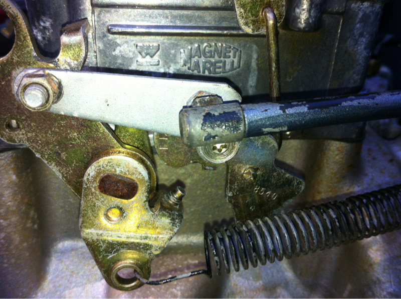

Did you do anything to the jeep before this or did this just start to happen out of nowhere?? As I understand it, when you close the choke, that makes a leaner condition, not when its open, so if you choke flap is wide open then the choke isnt leaning it out. have you adjusted the idle screws any to see if it will richen up? VAC LEAK somewhere??? Almost sounds like a big vac port on the carb is unpluged somewhere. I would start by sprying carb cleaner in every passage you can get to, and check good for vac leaks. Can you post a pic of the choke side of your carb?

that is a weber carb in the picture. that is what the w and the magneti marelli is from. weber made that for another manufacturer. have you popped the top o nthe carb and looked inside? if its dieing out slowly, i would imagine you are running out of fuel in the bowl or something like that. does it run warmer then normal or cooler then normal?
