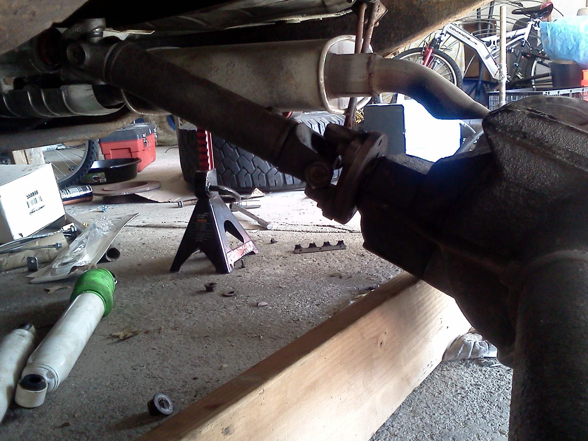

trying to get the welding going. This is the pitch. Does it look fine? it spins alright.

It's very wrong. For your single cardan setup you want the pinion angle parallel with the transfer case output.
Your setup is ideal for a CV (double-cardan) rear driveshaft, which yours is not.

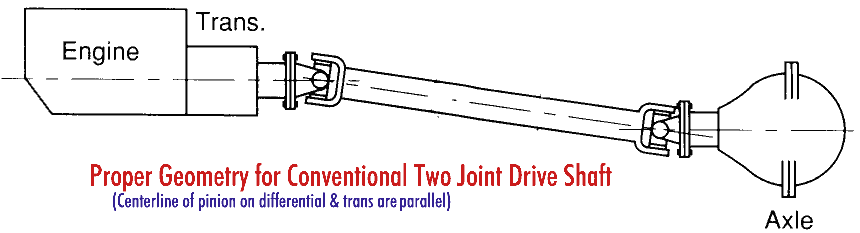

This is what you're shooting for:
Is all the weight on your rear suspension? I don't think you'll be able to get the rear pinion down to where it should be without the front ujoint binding. Your best answer is either a SYE install with CV rear driveshaft, or lower the transmission crossmember.
