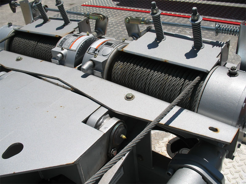

You can add a tensioner like what's found on tow trucks, it will help the cable spool better: 03-23-11tow-tip-photo-web.jpg
I can't think of anyone I dislike enough to let them mess with my rope under tension.
