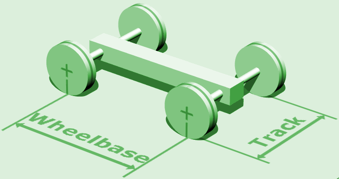

Do you mean that you want a longer wheelbase (front and rear wheels are stretched farther apart), or that you want your Jeep to be wider (a wider track)?
If you want a wider wheelbase then I'd imagine you'd just need to move your spring mounts and look into longer driveshafts.

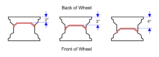

If it's a wider track, then you could get an inch or so by using spacers (probably not worth doing), or an easy solution would be to get wheels with the smallest amount of backspacing you can find (making the wheels stick out farther
