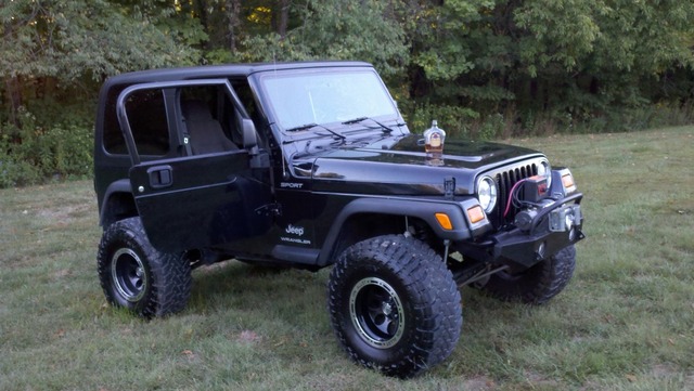

Diesel powered tj
stinkfist
my build
Welcome to the Z, that's a sweet looking Jeep. Can you tell us more about your motor swap?
thanks. sure, what do you want to know?

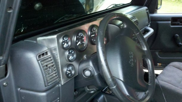

Everything. I know a guy with a 4BT powered YJ and that thing will pull stumps out of the ground. We are all about the details here.
it was a fun build and is a great dd. here are some more pics

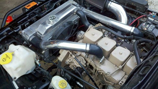

Looks like a 4bt. Did you go with A.A. to get it matched to the AX15? Tell us ALL you can..........
What axles are you running in your set up? I do not think the d35 nor the d30 would beable to handle the 4bt's torque. What gearing, tire size, etc are you running? RPM at highway speeds (70ish)? Have you changes out the fuel pin or the valve springs to run a higher rpm?
Noticed in one of your pictures, the engine was clocked a couple degrees to the passanger side. Is that the same degree/clocking from your donor truck?
Lastly, I am looking into doing the same kind of swap but with a NV4500. How long did your build take and did you do it all yourself?

Awsome!! That's a lot of iron to stuff into a TJ. You even got an intercooler into it. I like the dash. This must be off road only - or you don't need to pass emissions where you are. I bet you get great MPG. Yeah, what axles ARE you running? I would think the 4BT can easily grenade the stockers. Great job!! -John

as of now im running stock axles and theyve held up well with my driving. im running 3.07 gears in mine and seems really good. my tires are 33s and at 70 mph my rpms are around 1700-1800. yeah its the typical 8* tilt engine adapter found in all of those donor trucks, i took as much of the tilt out as i could when i built my mounts, you can buy a engine adapter that has no tilt for about 1200. yes i done all of the swap myself and it took about 7 wkds off n on to do it. but its been worth it
hey thanks. no off-roading yet, so far its pretty much a pavement princess:D yeah the 4bt could make a mess of the stock axles
