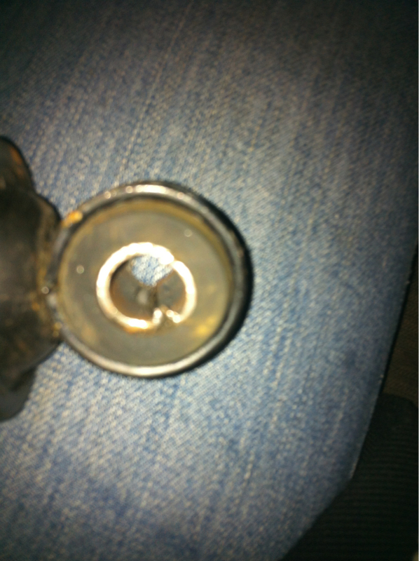

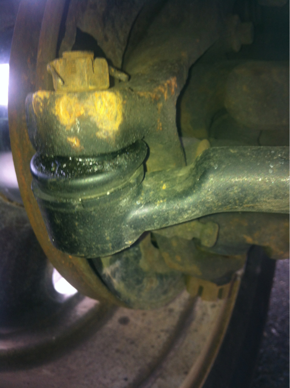

I started having a dw on 50 after i had my 03 tj 2" lifted with 32s. It happens mostly on 2wd. I replaced the steering damper, balanced my tires and alignment new ball joints. New tie rods 7 months old track bar. The only thing I haven't replaced is the stock sway links and I'm wondering if that could be the cause?!
Have you checked your tie rod? The best thing to do is carefully watch both tie rod ends while someone cycle's the steering from lock to lock.

The sleeve inside the bushing was big and had some room that allowed a little play till it got busted completely.I had every part checked today and all was tight and good except for the sway bar links they're little short for 2" lift. I tested the jeep and it seems ok now but this thing is driving me nuts!!!!! I drive mostly highway :/
