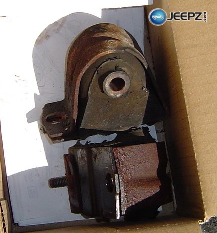

I ordered these mounts (pictured left) from quadratec, $100 shipped to my door for the pair. Installing them was certainly NOT a walk in the park, but nothing to terrible either.

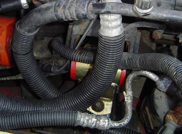

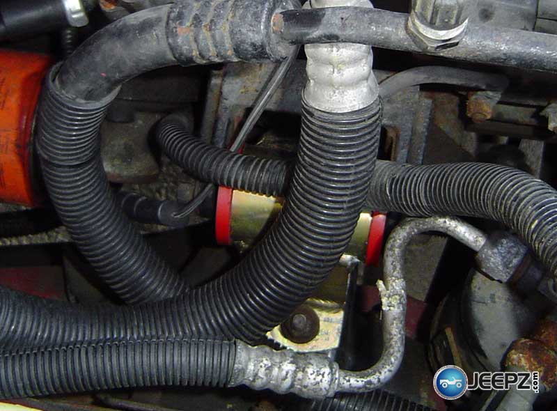

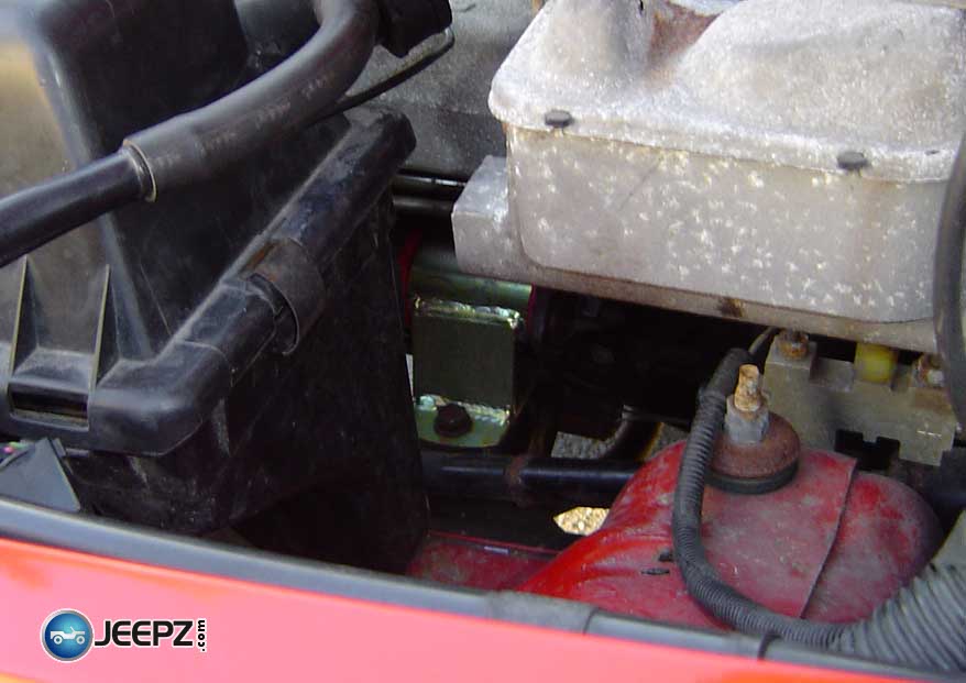

Had to take the airbox out to get the passenger side mount in, that went fine. Had to shave a part of the urethane bushing to clear the bracket but i'd consider that only a "minor modification" compared to what a headache the drivers' side was. After jacking the motor up and down 100 times and even trying to PULL THE MOTOR FORWARD half an inch, it was easier just to grind out the bolt holes so that the mount would just drop right in.
Driving it, I certainly do feel the vibrations you hear about when using urethane motor mounts but it is certainly better than the original stock mounts after 220k miles (pictured right). The design of the new mounts has the upper hand over the stock mounts, it seems that you could put 500HP to these mounts and they'd be fine all day long. The bushing itself is about an inch wider, not to mention its a harder material than the spongy stock mounts!
