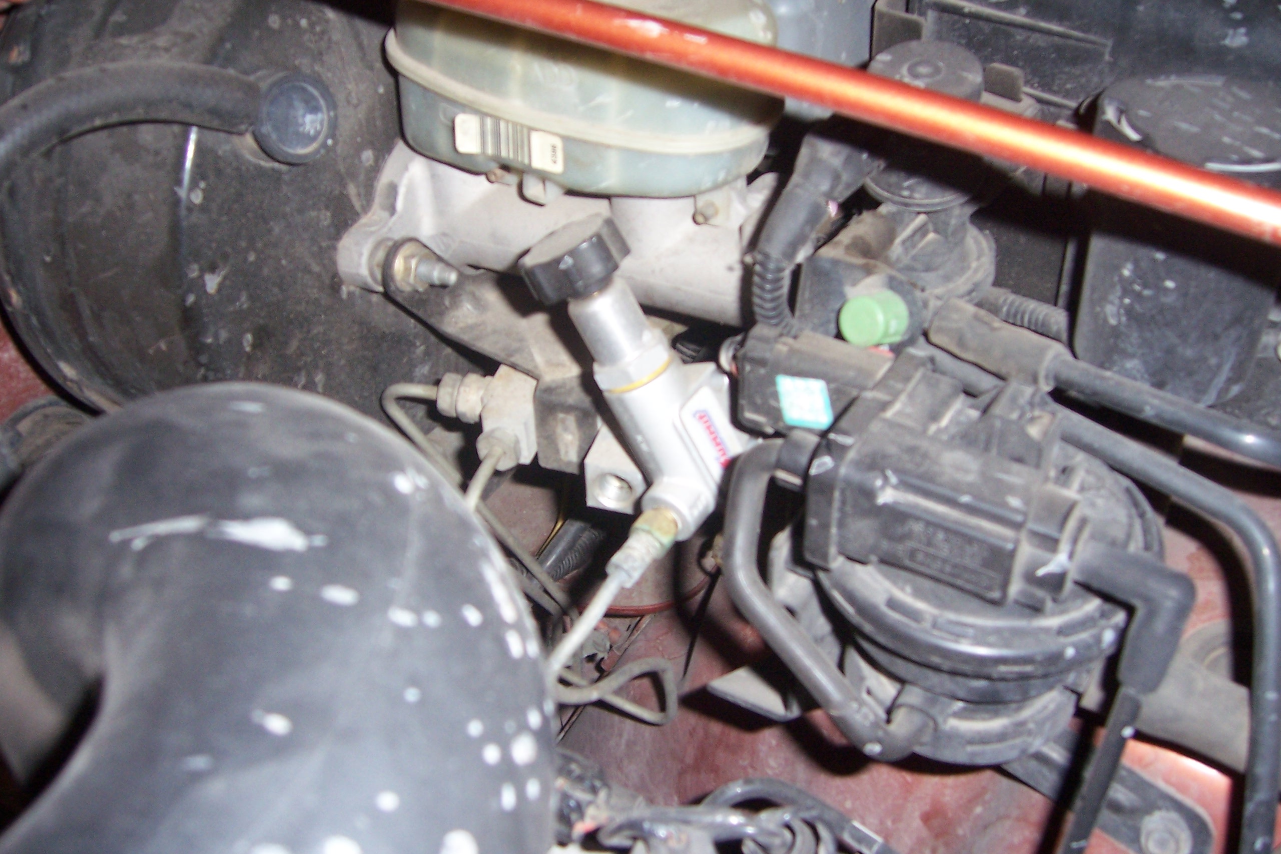

Brakes are a different matter, your current proportioning valve set-up is along the lines of 70-30. When I converted my D44 from drums to disc I ended up buying a manual proportioning valve from summit racing and set mine manually. I had to disconnect the low level warning off the proportioning valve but I do keep a good eye on my jeeps oil/brake fluid levels. It will still feel weak and jeep like. The only way to change is to do a full hydro-brake conversion. I have seen and heard of people going with Grand Cherokee proportioning valves since there factory equipt 4 wheel disc brakes but the valve is set for a heavier vehicle and it still feels funny to stomp on the brakes. Going to keep mine till I have 1500$ to blow on a new brake system.
