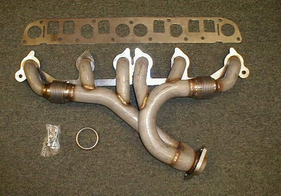

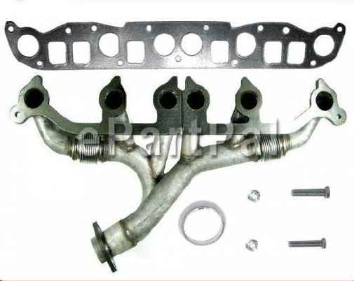

Does anyone have an opinion on these two? One's a little more spendy than the other, and I'm just not sure if there's a difference in quality.

It's difficult to tell the Quality of those 2 Manifolds in the pic. The quality is contingent on the wall thickness of the pipes and the flanges. Mandrel bent pipes are also better . If you could get the specs. from the manufacturer, you can make the comparison and descision on which one to purchase. Since both of them has the flex pipes on them, that in itself is already an improvement from the original design..
